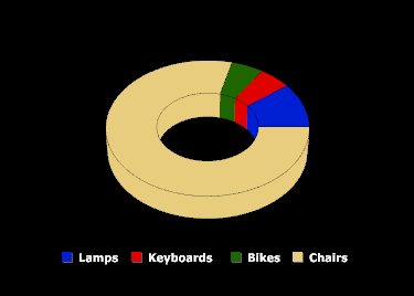

Re: DonutSeries
Post by Yeray » Mon Aug 29, 2016 10:09 am
Note OpenGL gives a better result. Ie:
n2n
Posts: 19
Joined: Mon Nov 23, 2015 12:00 am
Re: DonutSeries
Post by n2n » Fri Sep 23, 2016 6:39 am
Ok thanks. Can you give some example please?
Re: DonutSeries
Post by Yeray » Fri Sep 23, 2016 7:41 am
n2n wrote:Can you give some example please?
I took your example form here.
uses TeeGLCanvas;
  //Activate OpenGL
  Chart1.Canvas:=TGLCanvas.Create;
  Chart1.Aspect.Elevation:=40;
  //Show Pen to better see the slices
  DonutSeries1.Pen.Visible:=true;
  //Make the Pen thinner
  Chart1.Draw;
  DonutSeries1.PiePen.Width:=0;
I also added this
