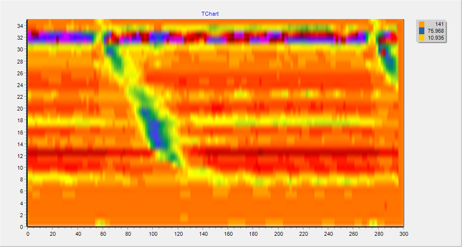

I wonder if with TChart component is possible to obtain the same color quality and resolution with colorgrid component relative to competing component TMS Software.
try to interpolate the data in the chart ,smoothing and yet the resolution does not improve, I would like to know if you have a better way to make this graph, based on the experience of you
using: teechartt pro 7:05 for Delphi 7
is attached example
greetings
Dynamed ind. with. ltda
is attached example
greetings
- Graphics
- HRM5.PNG (428.89 KiB) Viewed 22656 times

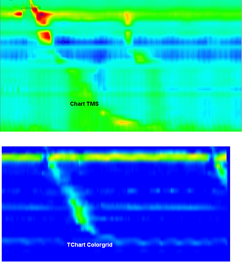

as spoken before the chart losses quality on cologrid chart and we need something near the competitor (TMS)

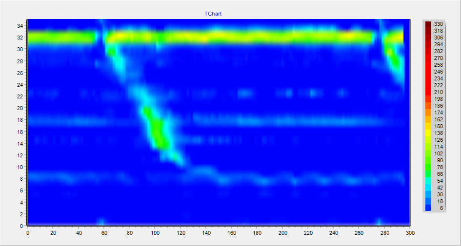

This is how the application you attached looks when using the current TeeChart version: That is pretty similar to what you get with TeeChart 7, isn't it?

Yes, but i would like that was similar or equal the above and improve the quality and appearance of the graph. The same of first graph using Delphi 7 and Teechart 7.05.

If I set SGrid.SmoothBitmap to false in your example, the ColorGrid looks like this: If I'm not wrong this resultant grid of 300x36 cells accurately represents your data.
An interpolation to reduce the size of the grid, calculating means, could make sense, but you are asking for the contrary.
Calculating new interpolation points between values would result in (1) fake values and (2) the same resultant grid, just with more resolution.
Is this what you would like to achieve?
Instead of doing this, SmoothBitmap feature in TeeChart's ColorGrid calls GDIPlus doing a "bicubic interpolation" of the pixels to smooth them.
