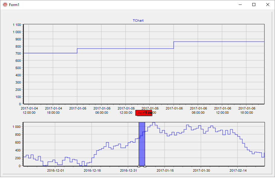

When chart is unzoomed it looks like this
There is a lot of free space below axis titile

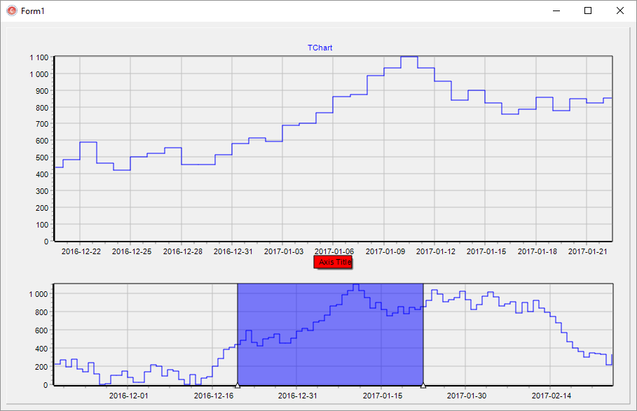

When one try to zoom and labels are really multiline labels are cover axis title.

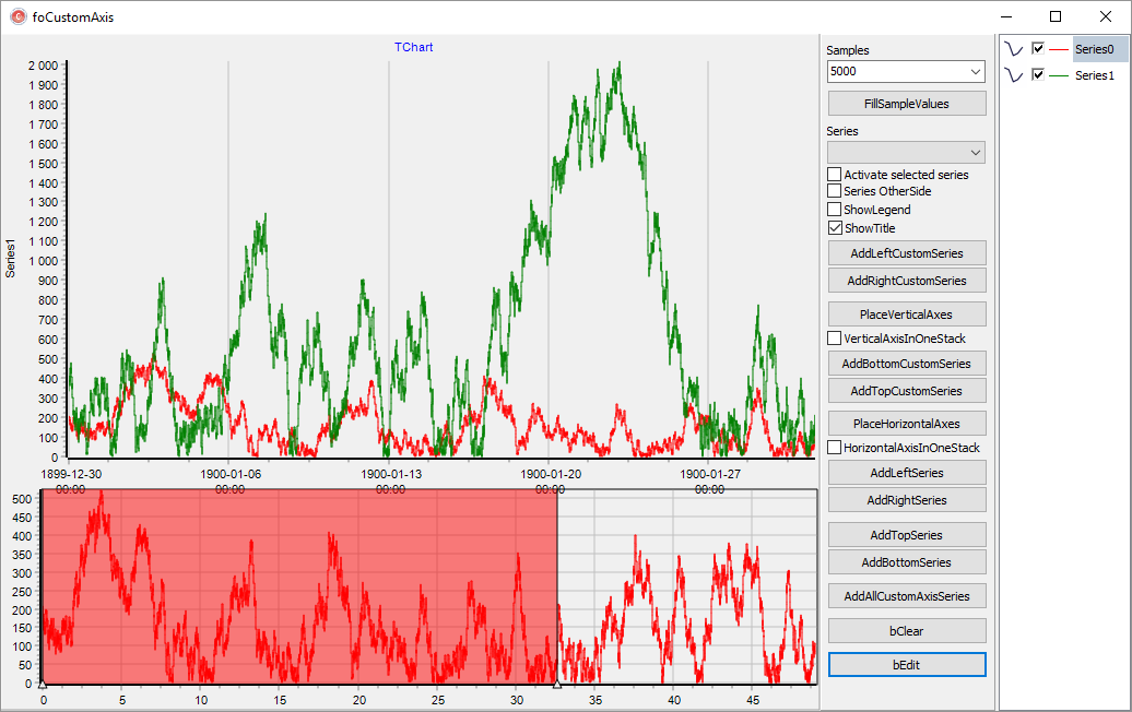

The fix that You send me works, but only for standard axis. On custom axis title overlap labels when multiline is enabled.
Grzegorz
Posts: 9674
Re: Axis label height calculation does not consider multiline
Post by Yeray » Tue Nov 22, 2016 9:47 am
This is a different issue, so I've created a new ticket:
http://bugs.teechart.net/show_bug.cgi?id=1692
