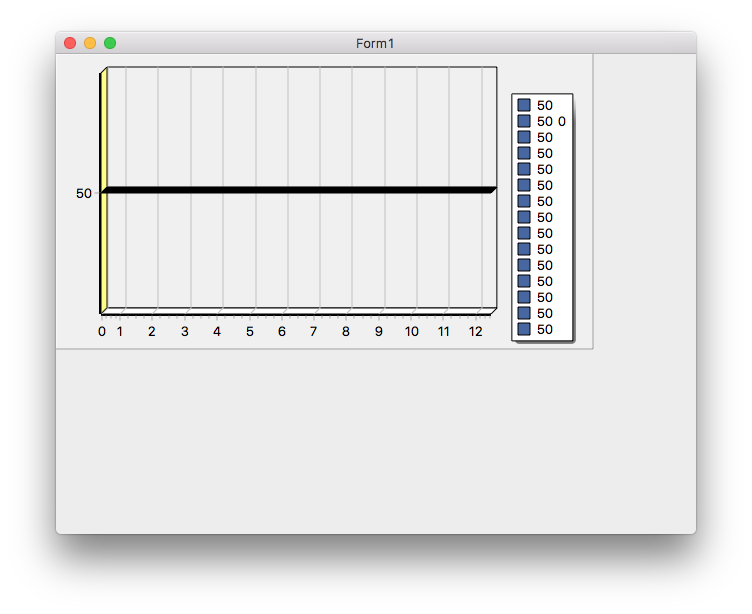

Post by Yeray » Mon Apr 10, 2017 10:45 am
I've just tried the code in the ticket #1701 in TeeChart v2017.21 using RAD 10.2 and it seems to work fine for me on OSX:

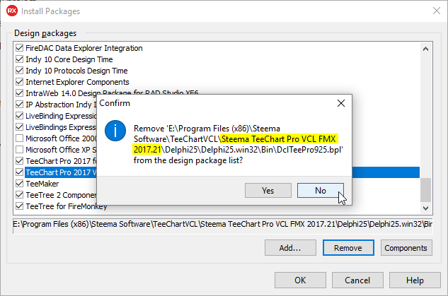

- Design-time packages: Go to "Component \ Install Packages..." and check the TeeChart packages in the list. A trick to see the full path of a package is to select it, click "Remove", read the path, and cancel the remove operation.

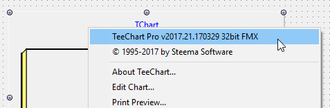

- Design-time packages: Open a form containing a form (or create it), right click with the mouse on the chart and read the "About" version.

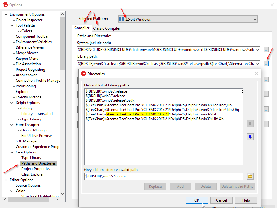

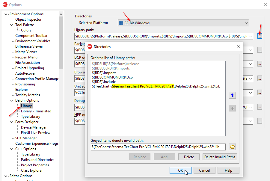

- Runtime packages (Delphi): Check the library path:

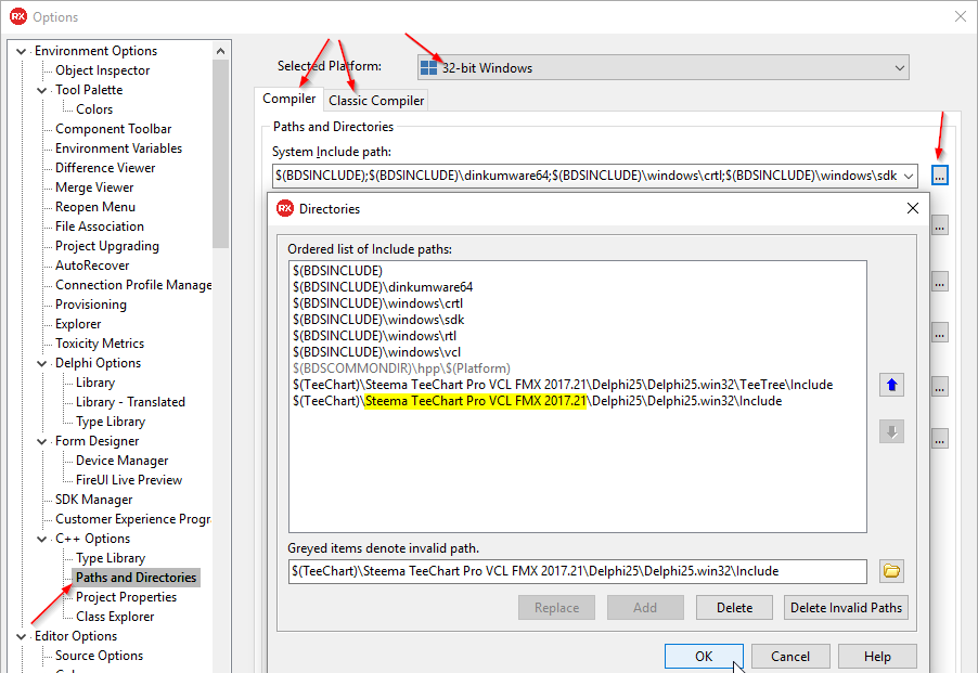

- Runtime packages (C++Builder): Check the include and the library paths:

for the first method way
I have 924.bl installed and not 925.bpl
even though I did install the latest update
