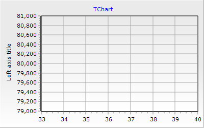

I've tried to reproduce the problem without success; it seems to work fine for me with a similar length in the axis labels. Ie:
uses Series;
  Chart1.View3D:=False;
  Chart1.Legend.Visible:=False;
  Chart1.AddSeries(TLineSeries);
  Chart1.Axes.Left.Title.Text:='Left axis title';
  Chart1.Axes.Left.SetMinMax(79000, 81000);
  Chart1.Axes.Bottom.SetMinMax(33, 40);
What TeeChart version are you using?
