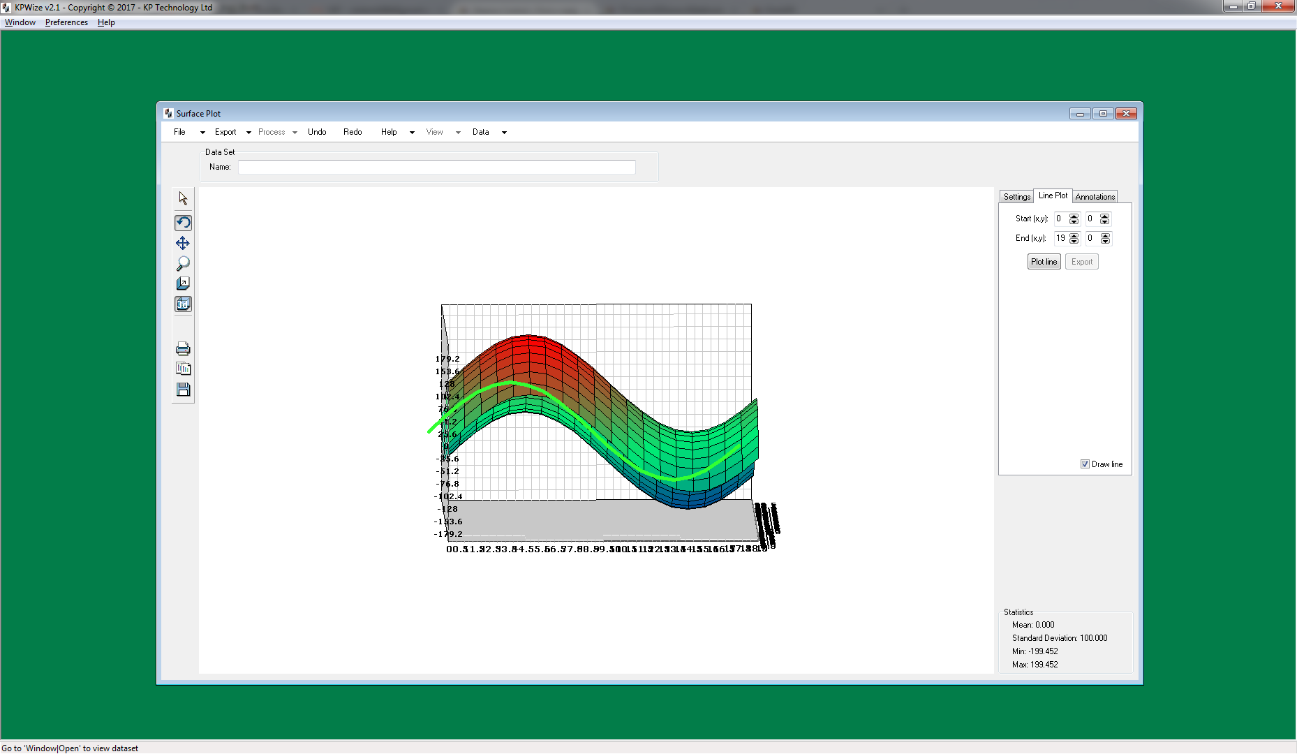

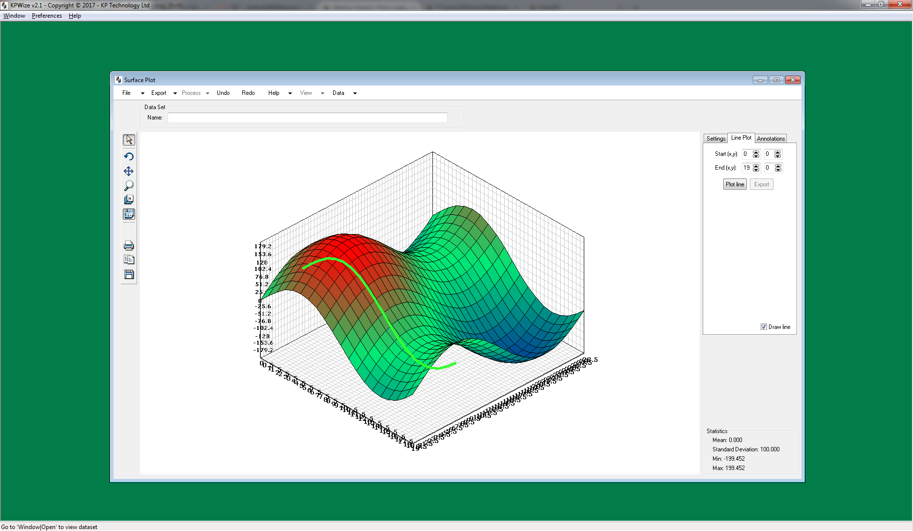

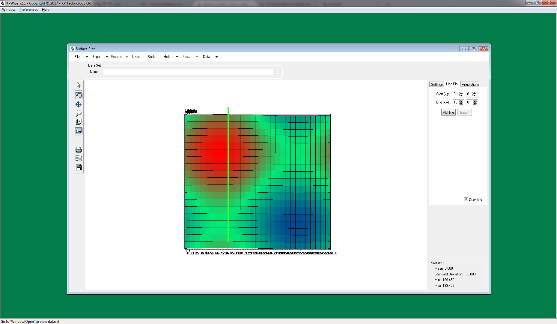

I used this method to draw on the line. I was attempting to use the real values in x, y and z to draw across the chart in each plane. The actual line produced looks perfect but its orientation is wrong. The x and y coordinates appear incorrect in a 3d context. Any advice would be appreciated.

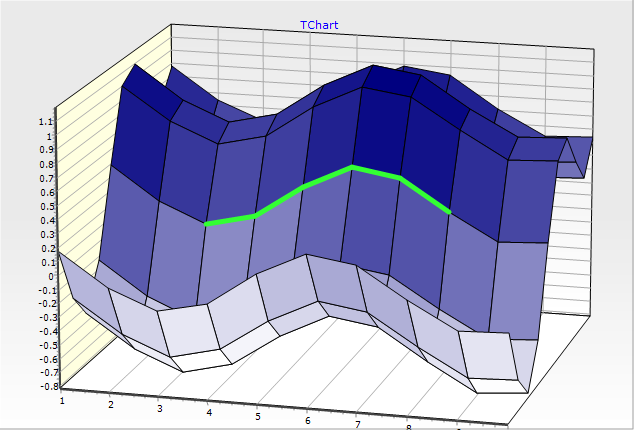

If you only want to highlight a part of your TSurfaceSeries you could just use a TPoint3DSeries. Ie:
var
  surfaceSeries: TSurfaceSeries;
  arbitraryLine: TPoint3DSeries;
var i: Integer;
  Chart1.Chart3DPercent:=100;
  Chart1.Aspect.Zoom:=80;
  Chart1.Aspect.Orthogonal:=False;
  Chart1.Legend.Hide;
  surfaceSeries:=Chart1.AddSeries(TSurfaceSeries) as TSurfaceSeries;
  surfaceSeries.FillSampleValues;
  arbitraryLine:=Chart1.AddSeries(TPoint3DSeries) as TPoint3DSeries;
  arbitraryLine.Pointer.Visible:=False;
  arbitraryLine.Pen.Color:=RGB(51,255,51);
  arbitraryLine.Pen.Width:=5;
  for i:=42 to 47 do
    arbitraryLine.AddXYZ(surfaceSeries.XValue[i], surfaceSeries.YValue[i], surfaceSeries.ZValue[i])
If you want to draw a line that isn't following consecutive points of your TSurfaceSeries, then you should draw the line manually as you were doing. Correcting the issues at the top of this post this way will probably work better.
