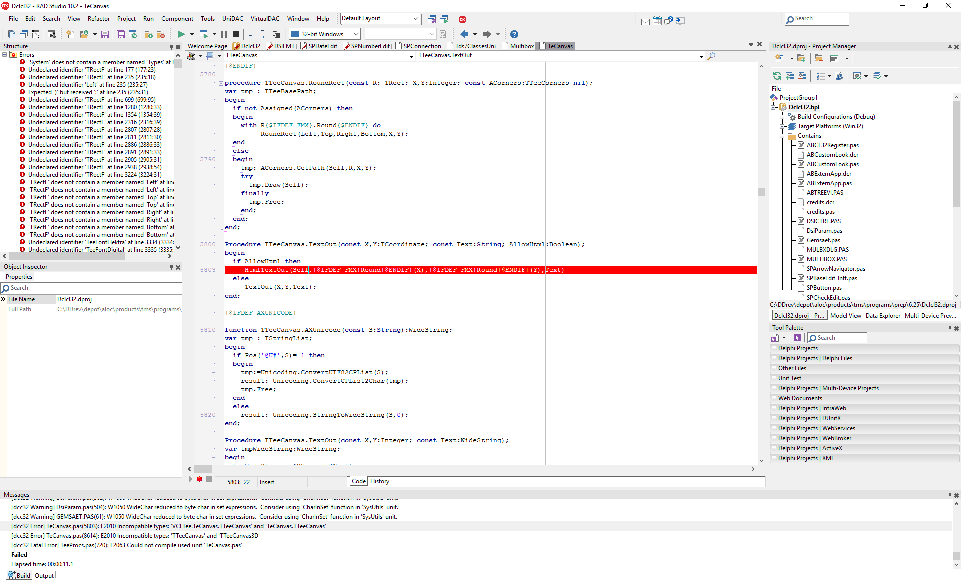

TeCanvas compile error.png (178.32 KiB) Viewed 13965 times
Hi again,
Sorry to bother you, but I seem to have stumbled on another problem with the TeCanvas.pas file.
I did put VCLTee in Unit Scope names, but now on opening an existing project, and compiling it, I get the error as seen on the image attached:
Incompatible types: VCLTee.TeCanvas.TTeeCanvas and TeCanvas.TTeeCanvas
And also Incompatible types TTeeCanvas and TTeeCanvas3d
Do you have any suggestions on what to do?
Thanks in advance
Posts: 9674
Re: TeCanvas not found
Post by Yeray » Wed Jul 12, 2017 9:38 am
Check the library path. You probably have the "Source" path above the "Source\VCL" path (or maybe you don't have the "Source\VCL" path on the list). This would explain why the compiler is finding TeCanvas.pas (present in the "Source" folder) before finding VCLTee.TeCanvas.pas (present in "Source\VCL" folder).

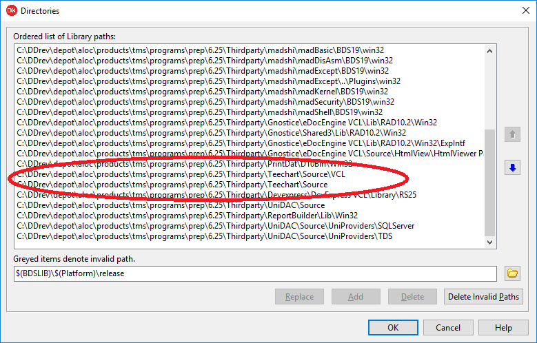

Jens
Posts: 4
Joined: Tue Jun 20, 2017 12:00 am
Post by Jens » Wed Jul 12, 2017 1:48 pm
TeCanvas compile error2.png (44.52 KiB) Viewed 13963 times
No, I have \Source\VCL above \Source
