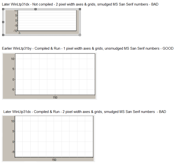

I think I have a bug in TChart. I am trying to have axes and grids of 1 pixel width, but they are all 2 pixels wide. I am also trying to use axes numbers with the MS Sans Serif (which is not 'smudged' like Arial), but I appear to have the smudged Arial number fonts. I am using RAD Studio XE 10.1 Berlin and VCL Chart Pro 2016.
In the Object Inspector I have put in things like
TChart1->LeftAxis->Axis->Width = 1
TChart1->LeftAxis->Grid->Width = 1
TChart1->LeftAxis->LabelsFont->Name = MS Sans Serif
but to no avail.
As shown in the attached TChart_2PixelAxesGrid_SmearedNumbers.png file, in the top panel, the non-compiled TChart in the RAD Studio development system INCORRECTLY show 2 pixel wide axes & grids, and smudged numbers that are NOT MS Sans Serif.
The middle panel shows an EARLIER compiled and run program showing the CORRECT 1 pixel wide axes & grids, and UNsmudged numbers that ARE MS Sans Serif. Note that the non-compiled TChart of this INCORRECTLY showed 2 pixel wide axes & grids, and smudged numbers that are NOT MS Sans Serif (not shown).
The bottom panel shows the LATER (current) compiled & run TChart NOW INCORRECTLY show 2 pixel wide axes & grids, and smudged numbers that are NOT MS Sans Serif.
First of all, shouldn't non-compiled TChart immediately show the axes and grid widths and LabelsFont name entered into the Object Inspector.
And second, what would cause the EARLIER program to compile & run correctly (1 pixel widths and MS Sans Serif) but not the LATER program (2 pixel widths and Arial? fonts)? Do you know of any 'magic' Object Inspector variable that can fix these problems including have the non-compiled TChart show what's in the Object Inspector.
but to no avail.

- TChartBUG_2PixelAxesGrid_SmearedNumbers.png (17.45 KiB) Viewed 28026 times

Thanks! Changing from GDI+ back to GDI was that magic change that pretty much fixed everything. The axes and grids are now correctly 1 pixel in width, and the font is the correct MS Sans Serif.
There is just one small problem that I can't seem to fix. I want the BottomAxis numbers to be 1 pixel up towards the Bottom Axis (to have 3 pixels between top of numbers and outer tic marks rather than 4). But I just cant seem to fix this extremely simple thing.
If you changed the program in TChartBug_DoublePixels.zip (first email) from GDI+ to GDI, and then moved the BottomAxis number up from 4 pixels between top of numbers and outer tic marks to 3 pixels, that should tell me how to solve my problem for my big program.

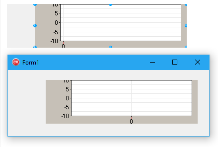

Unfortunately, changing Chart1->BottomAxis->LabelsSeparation to 1 (or to 0) in the ObjectInspector did not fix the problem - the number of pixels between the tic mark and the top of the numbers remained at 4 (ie did not decrease to 3).
I have included a downloadable simple program (TChartBug_NumPixels_BottomAxis_to_Numbers.zip) that shows that changing Chart1->BottomAxis->LabelsSeparation to 1 in the ObjectInspector did not fix the problem - the number of pixels between the tic mark and the top of the numbers remained at 4 (ie did not decrease to 3). - This new program is just the above TChartBug_DoublePixels.zip program but changed from GDI+ to GDI.
This new program can be downloaded from the following URL:
<https://fluff.bris.ac.uk/fluff/u3/anwwa ... 897UWAed6/>
and will remain there until: Tue Aug 15 22:59:59 2017 UTC.
I have also included a pictorial result of this program (TChartBug__NumPixels_BottomAxis_to_Numbers__GDI_LabelSep1.png - I added the red dots in Paint.exe).
Perhaps using this program to solve the problem would allow me to quickly fix this bug in my main program.
Thank you. Hope to hear from you soon.
Sincerely,
Bill Anderson

- TChartBug__NumPixels_BottomAxis_to_Numbers__GDI_LabelSep1.png (7.11 KiB) Viewed 27961 times

After reviewing your project. I think can help you, change LabelText MarginToAxis value to 0. The line below shows you how can do that:
Could you confirm us if the code works in your end?
Thanks in advance
Many thanks for the project.
TChartCalcX->Axes->Bottom->Texts->MarginToAxis = 0;
Thanks in advance

All the problems in this thread have been solved.
The cause of the last bug turned out to be a TChart hidden on a normally unused hidden tabsheet. Removing this TChart and removing all the references to <VclTee.TeeGDIPlus.hpp> fixed the problem.
Many Thanks.
