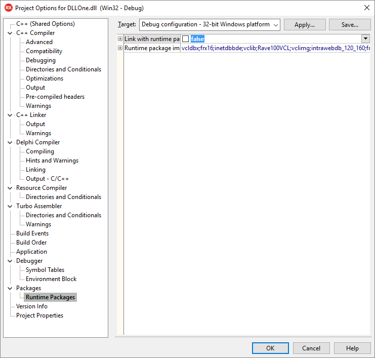

Try unchecking "link with runtime packages" in all the dlls.

RG Solutions wrote:In the test case that I sent, it has both the DEBUG and RELEASE builds. The DEBUG build uses "static" linking for the DLLs, and the RELEASE build uses "dynamic" linking for both DLLs. The problem still occurs whether you use "static" or "dynamic" linking.
I meant the "link with runtime packages" option here:

Regarding your suggestion about make "Link with runtime packages" false. This is great if you have a single DLL or no DLLs at all. However, if you are using multiple DLLs it is almost always necessary to "Link with runtime packages" for two reasons. The first is the size of the files. When you have 34 different object files as part of the install, this takes up a huge amount of extra disk space. The second issue is that with multiple DLLs, if they are not "Linked with runtime packages", then you most surely will have VCL conflicts and the program will not run. The only way I have been able to make my processing run is linking with runtime packages.
