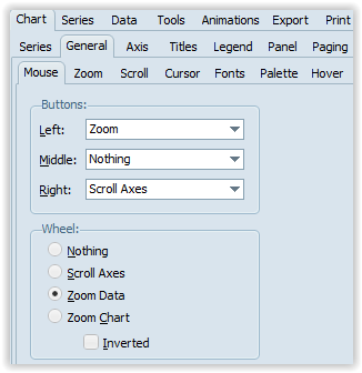

When I open the plot edit tool in my program, I find that under chart | general | mouse one can select 'zoom chart' in the wheel group box (see screenshot below).
How can one do this programmatically?

But this just allows one to zoom just the data with the mouse wheel, not the chart. How can one specify zooming the chart rather than just the data?

If you want zoom the Chart instead of Data, you need use Chart1.ZoomWheel property instead of Chart1.Zoom.MouseWheel. You should do the same as next line code:
  Chart1.ZoomWheel:= pmwnormal;

Thanks must be some additional settings needed as it does not work for me - it still zooms the data and not the chart.

If I use the edit tool to set it to zoom the chart then it works fine but i need to set it programmatically. There must be something else I have to set or unset.

You should disable the Data Zoom . I have modified your simple code because it works in your end. The modifications are shown below:
chart.Zoom.Allow := true;
Chart.Zoom.MouseWheel := pmwNone;
chart.ZoomWheel := pmwNormal;
Chart.BottomAxis.LabelStyle := talValue;
Hoping this helps you.

Excellent - that works!
