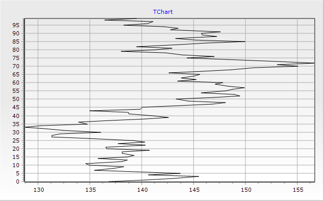

I guess this code is fired inside some to that sets ValueTobePlotted variable, but without knowing exactly how I'm afraid I can't reproduce the problem here.
This simple example seems to work fine for me here:
uses Series;
var i: Integer;
  Chart1.View3D:=False;
  Chart1.Legend.Visible:=False;
  with Chart1.AddSeries(THorizLineSeries) do
    AddXY(100+random*50,0,'',clBlack);
    for i:=1 to 99 do
      AddXY(XValues[i-1]+random*10-5,i,'',clBlack);
