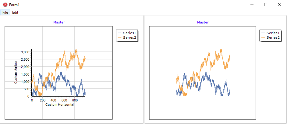

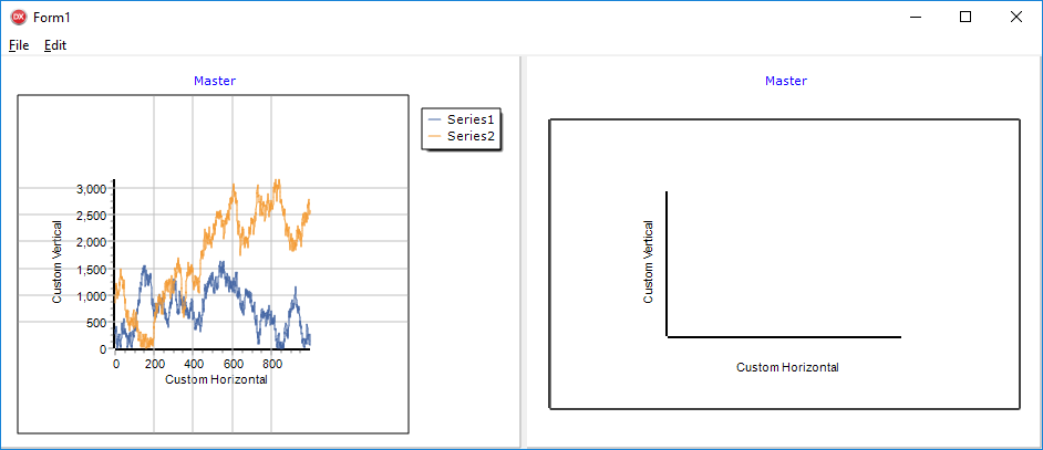

If there are custom axes on a chart, CloneChart does not copy them. The only way to duplicate such chart appears to be Save it to Stream and Load the stream in the new chart.
if Master is the original chart and clone is its duplicate, I get the following results:
Clone.Assign(Master):
  CloneChart(clone, master, self, FALSE):
When I use save to/load from stream, I get proper results. A simple project is attached. Use Edit->Copy(Assign), Edit->Copy(Clone) and Edit->Copy(Stream) to see the effects.

This sounds as the very same ticket #780, isn't it?

roumen wrote:It is disappointing that the problem was reported in 2013 and in 2018 CloneChart is not doing what it is supposed to do still...
You are right. I've revised the ticket #780 and just implemented a fix for it.
Since you own the TeeChart sources - and it's pretty simple - you can implement it and (Tee)Recompile them.
At CloneChart method in Chart.pas, add this after the loop where the series are cloned:
procedure CloneChart(const Dest,Origin:TCustomChart; const AOwner:TComponent; ForceManualData:Boolean);
  for t:=0 to Origin.SeriesCount-1 do
      CloneChartSeries(Origin[t],AOwner,Dest);
  // Relink Custom Axes within Destination Series
    if Origin[t].CustomVertAxis <> nil then
       Dest[t].CustomVertAxis:=Dest.CustomAxes[Origin[t].CustomVertAxis.Index];
    if Origin[t].CustomHorizAxis <> nil then
       Dest[t].CustomHorizAxis:=Dest.CustomAxes[Origin[t].CustomHorizAxis.Index];
