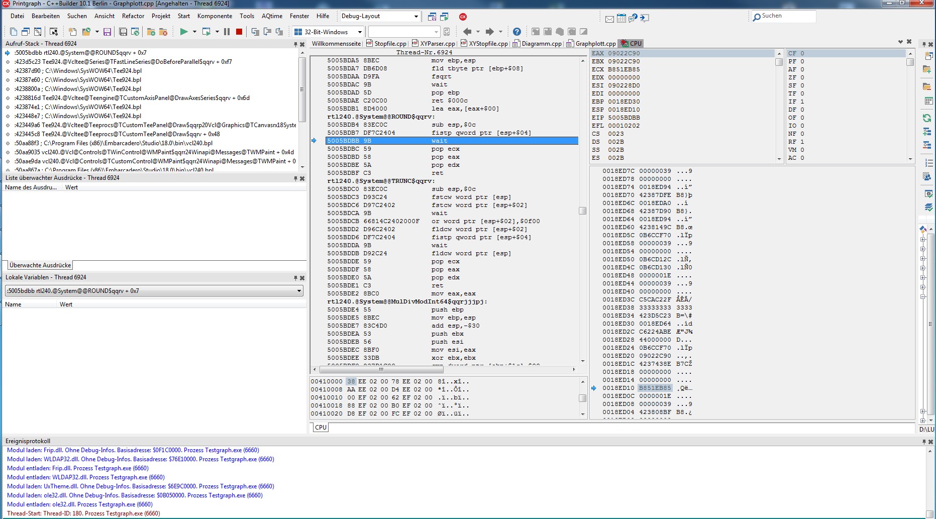

I'm using Teechart Pro 2017(.22) VCL Component and get an Invalid Floating error. The Version 2017.21 has the failure too. Sometime you get the failure and now under a Special Setting every time. I'm using the TFastLineSeries and I would say it crashs inside the Routine DoBeforeParallel by using the ROUNDS function of rtl240.bpl. I have put a Screen shot of this inside the attachment, where you can see the CPU view too.
I hope you can help me. This is a big big problem for us, because we will release our sw.

- TChart_Floating point error.jpg (451.57 KiB) Viewed 11863 times
