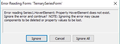

Unfortunately, I am unable to run the program you provided. I am using Delphi XE10.1 Berlin and have just downloaded and installed TeeChart 2018.26. The error I get is shown here
Any assistance gratefully received.

That error seems to suggest you don't have the latest TeeChart packages installed in Berlin because the HoverElement property was introduced in v2018.26.
Anyway, you should be able to manually edit the .dfm and remove the line where the HoverElement property is used. then you should be able to load the form without problems.

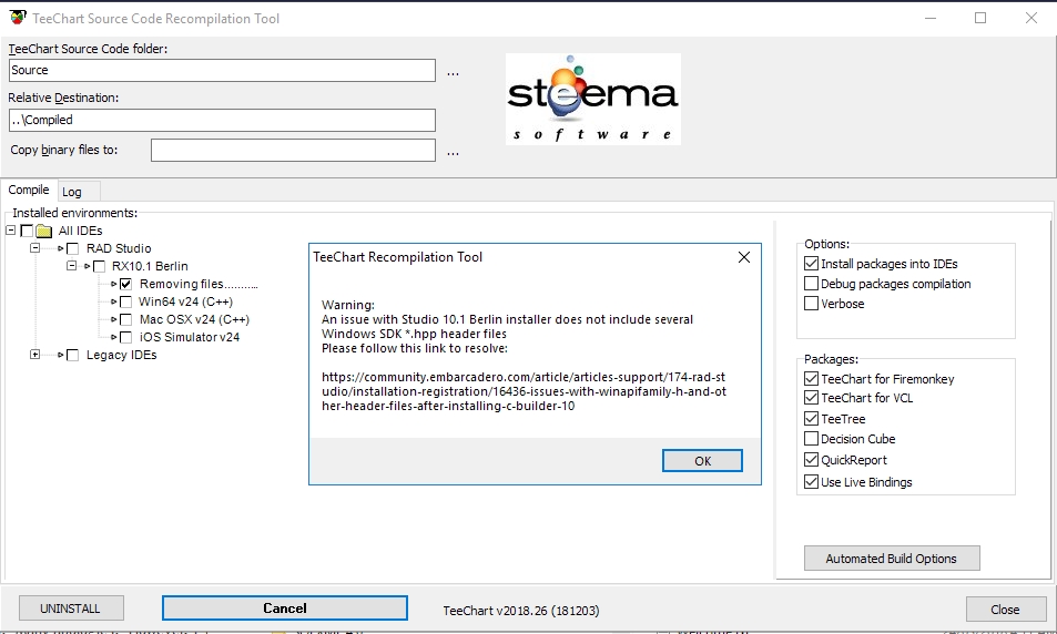

1. When I run TeeRecompile I initially get this error.
Windows header files missing
I ignored this as I am not using any C++ projects (and the link provided is not helpful as I do not have a current subscription for Delphi XE10.1).

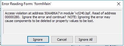

2. Somewhere in the process of installing the latest version of TeeChart, something has broken in my regular programs. I get the following error when loading forms that use VCLTee components.
Error opening form that uses VCLTee units
Have you any ideas what might have gone wrong here?

I have solved the problems with some forms containing TeeChart components not opening. Evidently a component library had to be rebuilt before these forms would work. Many apologies for any inconvenience caused.
If you still have problems, I would try to reinstall TeeChart using the "..\Compiled" Relative Destination as per default, and "as administrator" to avoid permissions limitations.
