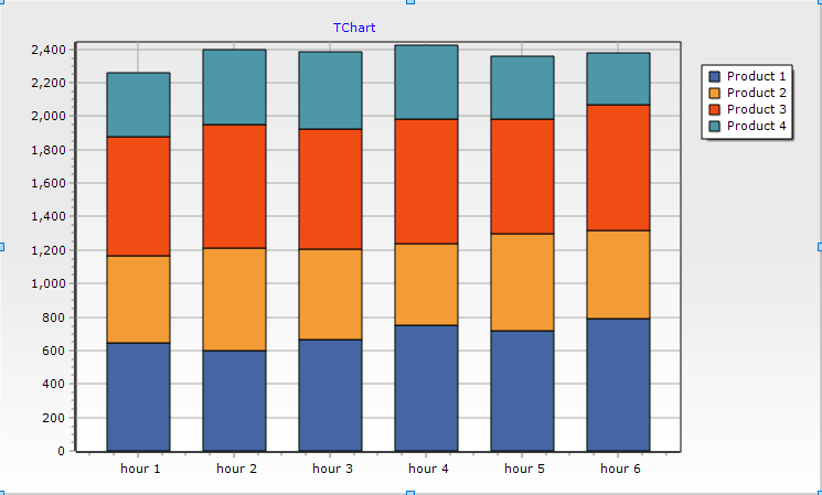

Something like this?
I did this at design time, adding 4 series, setting their titles, setting them to be Stacked, and setting their labels "hour1", "hour 2",...

Thanks Yeray,
Yes, exactly this kind of chart.
So, I understand now that each bar segment is associated to a particular series and color as well.
However, in my project I need to use a Dataset whose number of products and quantity varies each hour, so how can I make the association of the Dataset with the series to ensure that the bar and their segments appear or disappear, grow or shrink, on runtime?
To be more precise, I'm currently using only one series made at design time connected to a Dataset (see below) with a Summary, Sum of CantMatched column for Calc and using FH_Creacion for Group by, however it shows only one segment and color.

If the dataset is not very big, the easiest would be to completely remove the chart and recreate all the series and points for each series every hour. This way, you'll always have fresh data in your chart.
Regarding the exact code you are using, it's difficult to see what's exactly going on without a simple example.
