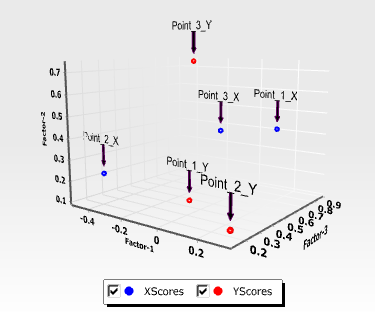

Here is a project showing 3 bugs that I noticed already for a long time and that are somehow not getting fixed in any release:
1) The position of the title of the Depth Right axis is completely OFF (for OpenGL mode)
2) The Mark Tips tool doesn't work at all in 3D OpenGL mode (No hints get shown)
3) It is impossible to switch ON/OFF series in the Legend when the Chart/TeeCommander mode is different from Select mode, which is very disturbing. In 2D mode it is well possible to zoom AND use the Legend for switching on/off series.

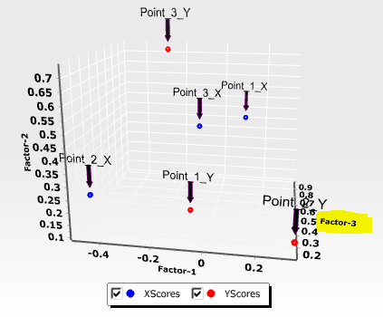

the change in TGLCanvas.RotateLabel3D indeed fixes the position of the axis label but still, the orientation is obviously wrong:
Wrong orientation of depth axis label
Can you please fix that too?
The label should like all others run along the axis.
Thanks and best regards,
Thomas

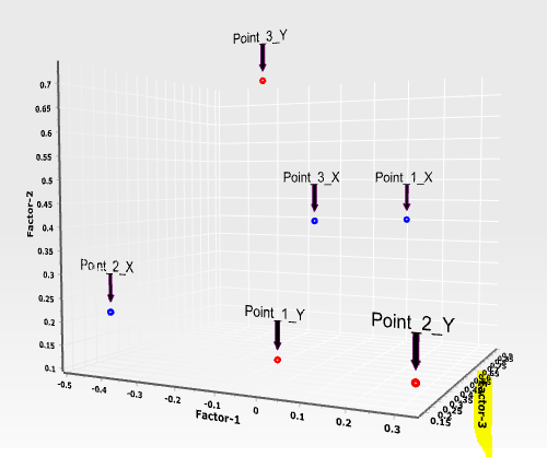

No, that doesn't help, the Title still shows a wrong alignment:
wrong alignment
The Title should run parallel to the axis, like the Titles of all other axes,
this title rotates perpendicular to the axis around the axis.
Thomas

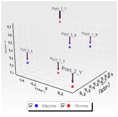

Post by axrDegen » Mon Dec 16, 2019 10:08 am
Hello Yeray,
that is indeed bad, I had expected it to look something like that:
best regards,
Thomas

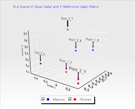

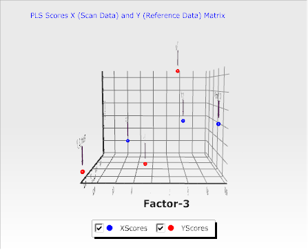

Post by Yeray » Tue Dec 17, 2019 11:08 am
That could be achieved incrementing the font size. However, the axis title would be in a plane perpendicular to the labels for the same axis. So, if you rotate the chart to see the title from the front, you won't be able to read the labels.
uses OpenGL2;
procedure TForm2.FillTheScoreChart(TheChart: TChart; Color: TColor; Title: string; IsVisible: Boolean);
    TheChart.DepthAxis.Title.Font.Size:=15;
    TheChart.DepthAxis.Title.Visible:=False;
procedure TForm2.PLSScoresChartAfterDraw(Sender: TObject);
var x, y, z, RotDegree: Integer;
  with PLSScoresChart.Axes.Depth do
    RotDegree:=Title.Angle;
    x:=PosTitle;
    y:=PLSScoresChart.ChartRect.Bottom-Round(PLSScoresChart.ChartHeight*ZPosition*0.01);
    z:=PLSScoresChart.Width3D div 2;
    glPushMatrix;
    glTranslatef(x,0,0);
    glRotatef(-RotDegree,0,1,0);
    //glTranslatef(-x,0,0);
    PLSScoresChart.Canvas.Font.Assign(Title.Font);
    PLSScoresChart.Canvas.TextOut(Z-20,Y+15,Title.Text);
    glPopMatrix;
