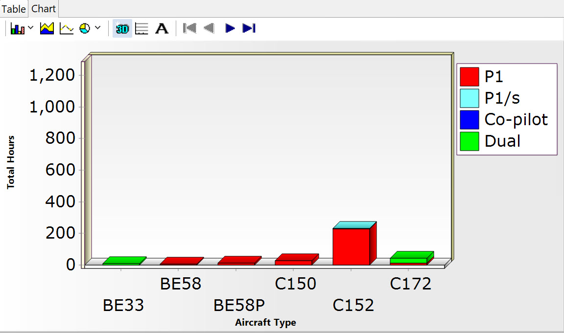

Found the problem. The Chart>Axis>Left/Bottom>Labels>Size settings were 33 and 27 respectively. These were fine for 100% scaling but not for 175%; setting them both to 0 fixed the problem. I wouldn't have found this problem if I hadn't been able to compare all my properties and settings with the one's in Ed's demo! I think you still need to fix your Navigator buttons for high-DPI though.

However... Just noticed that, although there is now no overlapping between axis titles and labels, the axis titles now aren't scaled up at 175%! How do I fix that?

Actually, measured them at 100 and 175% with a ruler and they are scaled up. So please ignore my comment.
