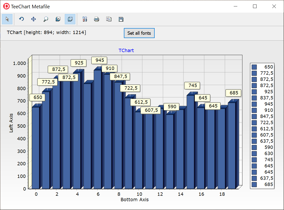

This is what I get at 175% (I can't set it to 200%) commenting the code at the ChangeScale override.
The "Set all fonts" button is only setting the same font for all the chart elements, to see differences clearer if any:
procedure TForm7.BAllFontsClick(Sender: TObject);
  procedure SetFont(AFont: TTeeFont);
    AFont.Name:=Label1.Font.Name;
    AFont.Size:=Label1.Font.Size;
  SetFont(Chart1.Title.Font);
  SetFont(Chart1.Axes.Left.LabelsFont);
  SetFont(Chart1.Axes.Bottom.LabelsFont);
  SetFont(Chart1.Legend.Font);
  SetFont(Series1.Marks.Font);
