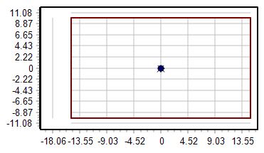

Although the following codes are used, Axis Labels of Increment, Minimum and Maximum values does not show a "rounded" value. What's the story?
      for i := 0 to aChart.Axes.Count - 1 do
          with Axes[i] do
              Automatic := true;
              RoundFirstLabel := true;
              MinimumRound := true;
              MaximumRound := true;

Got the problem. The reason is that the following code is used for TChart.Axes.
LabelsSeparation := 0;
So, TChartAxis skip calculating overlapping labels.
By default, Axis Labels are often too sparse. Is there a better way to mark Axis Labels as closely as possible? Except, LabelsSeparation := 1.

I'm afraid the only alternative would be to manually populate the labels yourself. Ie:
var lHeight: Integer;
    curVal: Double;
    dif: Double;
  Chart1.AddSeries(TPointSeries).FillSampleValues(10);
  lHeight:=Chart1.Axes.Left.LabelHeight(Chart1[0].YValues.MaxValue);
  Chart1.Draw;
  dif:=Chart1.Axes.Left.CalcPosPoint(Chart1.Axes.Left.CalcPosValue(Chart1[0].YValues.MaxValue)+lHeight)-Chart1[0].YValues.MaxValue;
  curVal:=Chart1[0].YValues.MaxValue;
  Chart1.Axes.Left.Items.Clear;
  while curVal>=Chart1[0].YValues.MinValue do
    Chart1.Axes.Left.Items.Add(curVal, FormatFloat('#.##0,##', curVal));
    curVal:=curVal+dif;
