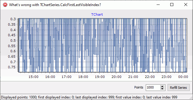

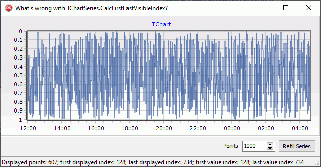

Returning to this post from five years ago, I never had time to pursue the problem, but I need to now. The issue seems to persist today with TeeChart Pro v2019.27.190530 32bit VCL in Delphi 10.3 Version 26.0.33219.4899. Not sure that it has been dealt with in any other posts on this forum. The attached project shows what happens.
I fill an inverted, stair-mode TFastLineSeries on a date-time horizontal axis with 1000 random points. The series is displayed.
I call CalcFirstLastVisibleIndex. The series' VisibleCount property is then zero, as are its FirstDisplayedIndex, LastDisplayedIndex, FirstValueIndex and LastValueIndex. That's wrong for a start.
I zoom in using the mouse, call CalcFirstLastVisibleIndex in the OnZoom event. Then the series reports 1000 displayed points, first and last indices 0 and 999. So, wrong again, one step behind.
I zoom out using the mouse, call CalcFirstLastVisibleIndex in the OnUndoZoom event. The series now reports 529 displayed points, between indices 80 and 608. Again, wrong and one step behind.
Calling CalcFirstLastVisibleIndex twice doesn't help.
So, clearly I misunderstand the meaning of this method and these properties. How do I get the series to tell me how many points it has displayed?
And what is the difference between FirstDisplayedIndex and FirstValueIndex? When are they ever different?

- 2. Zoom In.gif (35.44 KiB) Viewed 20222 times
- 3. Zoom Extents.gif (38.04 KiB) Viewed 20222 times
