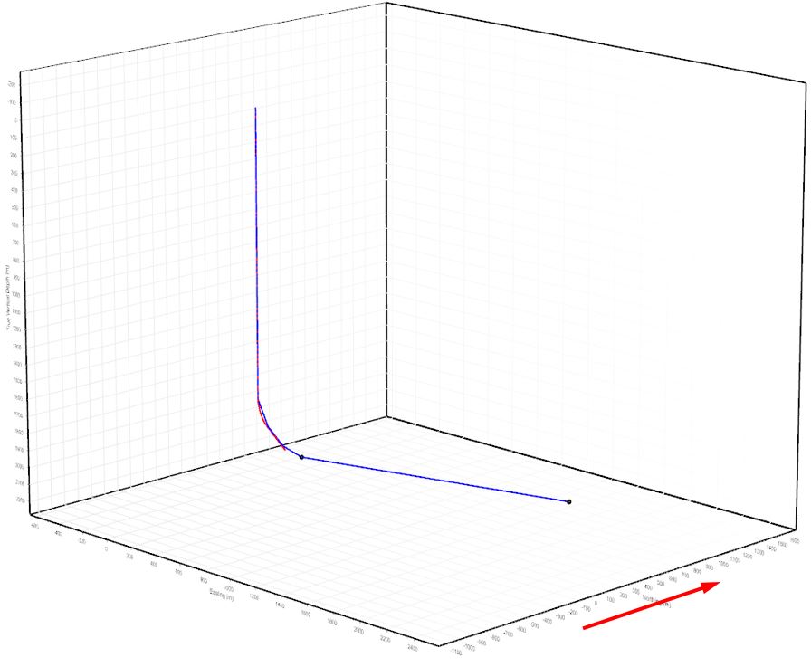

In a 3D Chart, I want that Axes.Depth.Title is arranged along the axis (See the red line with an arrow in the attached figure). Although the following codes were used, it still does not work. How to solve this problem?
procedure TfrmUPlot3D.TheChartBeforeDrawSeries(Sender: TObject);
var
  aStart, aEnd: TPoint;
  aStart2D, aEnd2D: TPoint3D;
  aAngle: Double;
  with TheChart do
      aStart2D.X := Axes.Depth.PosAxis;
      aStart2D.Y := ChartRect.Bottom;
      aStart2D.z := Axes.Depth.IStartPos;
      aStart := Canvas.Calculate3DPosition(aStart2D);
      aEnd2D.X := Axes.Depth.PosAxis;
      aEnd2D.Y := ChartRect.Bottom;
      aEnd2D.z := Axes.Depth.IEndPos;
      aEnd := Canvas.Calculate3DPosition(aEnd2D);
      aAngle := ArcTan2(aEnd.Y - aStart.Y, aEnd.X - aStart.X);
      Axes.Depth.Title.Angle := 360 - Round(aAngle / TeePiStep);

Post by Yeray » Thu Sep 17, 2020 6:07 am
Take a look at the discussion and code here.

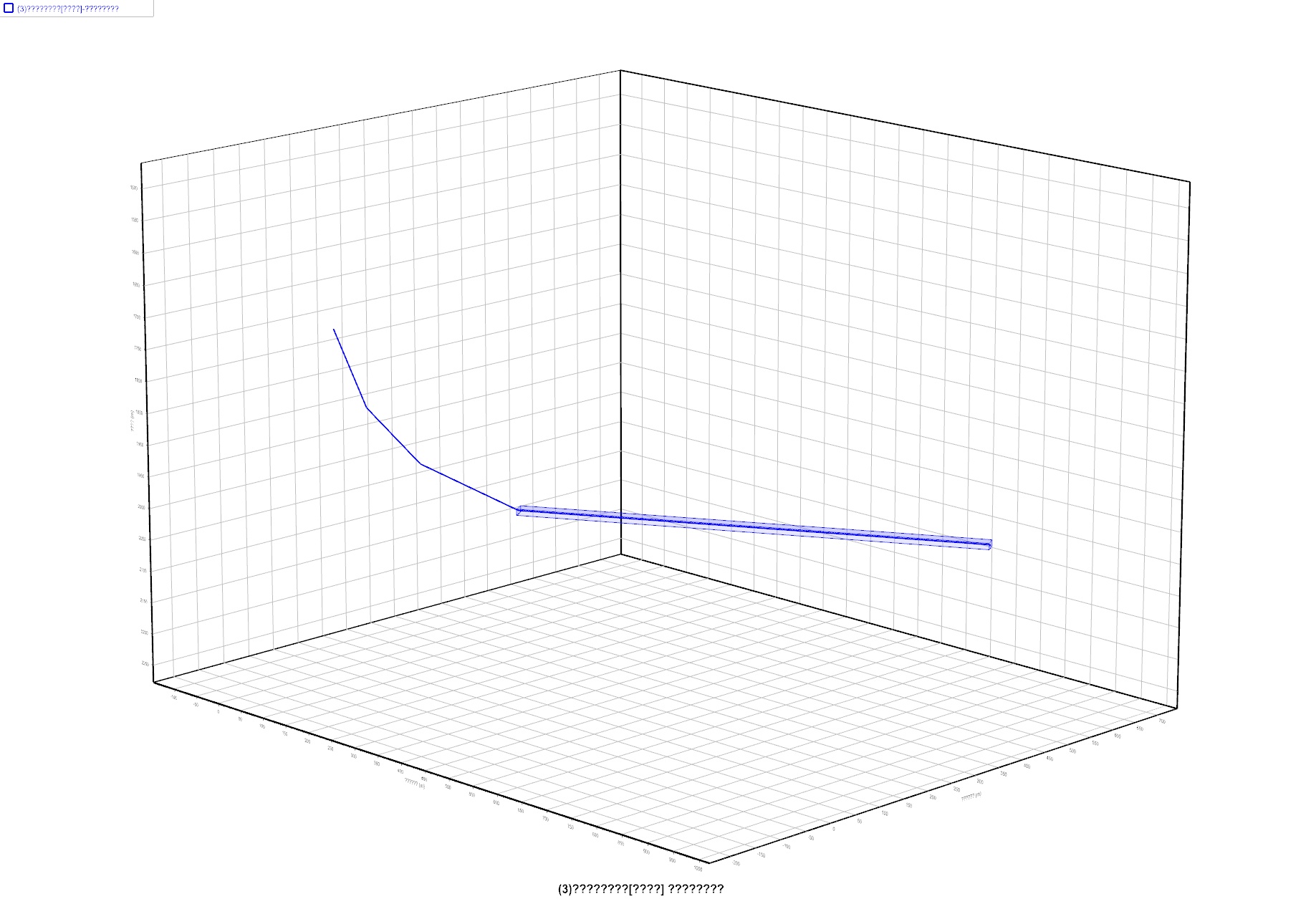

Chinese characters are displayed on the GLCanvas in messy codes. Please find the attached file, and see Chart.Title, Chart.Legend, Axes.Title.
Any suggestions? Would you like to give me an example? Thanks a lot!

Post by Yeray » Fri Dec 11, 2020 9:00 am
That's a known issue already in the public tracker:
http://bugs.teechart.net/show_bug.cgi?id=1728

If I don't use GLCanvas, is there any other way to arrange Axes.Depth.Title along the axis?
Re: Axes.Depth.Title.Angle
Post by Yeray » Thu Dec 17, 2020 10:43 am
xsLiu wrote:
Fri Dec 11, 2020 6:58 pm
This is precisely one of the points to consider in #2272.
