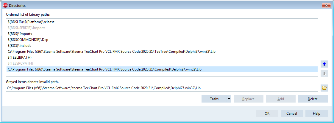

Looking at the Library paths, I see this:
Are you saying I need to add another line, that points to Source\VCL ?
Also, why is the $(TEESRCPATH) flagged as an invalid path by the IDE?

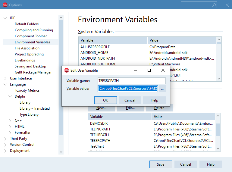

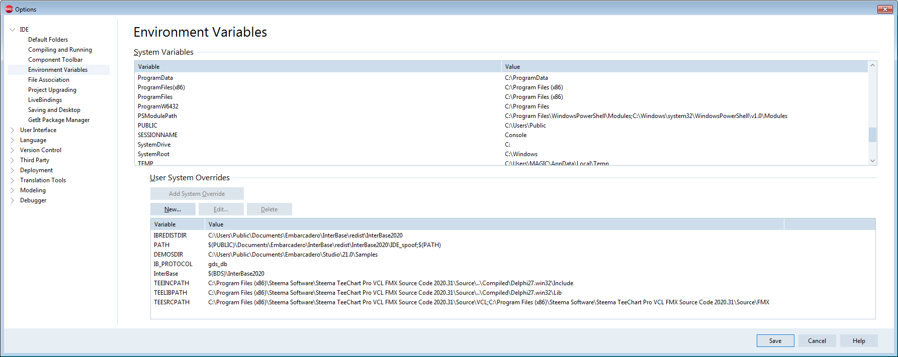

Re: [dcc32 Fatal Error] VCLTee.TeeHtml.pas when building project - Rad Studio 10.4.2, TeeChart source v2020
Post by Yeray » Tue Jun 08, 2021 10:59 am
Is the TEESRCPATH defined in the environment variables?
It probably is, and it probably has the value: C:\Program Files (x86)\Steema Software\Steema TeeChart Pro VCL FMX Source Code 2020.31\Source\VCL;C:\Program Files (x86)\Steema Software\Steema TeeChart Pro VCL FMX Source Code 2020.31\Source\FMX
Note there are two paths in the same variable (separated by a ;), which the compiler parses without issues, but the IDE flags it as an invalid path in that editor.
Then, if you want to compile TeeChart as you go, you can leave $(TEESRCPATH) in the Library path. If you just want to use the compiled packages, you can remove $(TEESRCPATH) and leave $(TEELIBPATH) or C:\Program Files (x86)\Steema Software\Steema TeeChart Pro VCL FMX Source Code 2020.31\Compiled\Delphi27.win32\Lib which should be the same.

TEESRCPATH is defined in the environment variables on my system too.
