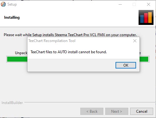

I am getting the following error when installing. (Install Error1.jpg)

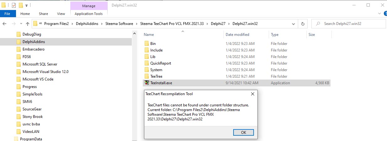

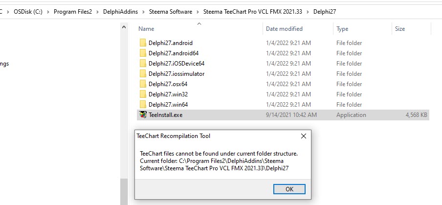

I let it finish and tried to install "TeeInstall.exe" and it also gave an error "TeeChart files cannot be found under current folder structure" (InstallError2.jpg)

It works for me from the "Delphi27" folder but we'll revise that.
In the meanwhile, could you please try to move TeeInstall.exe to "Delphi27.win32" and run it from there?

I tried moving the exe to the "Delphi27.win32" folder , and got the same error.

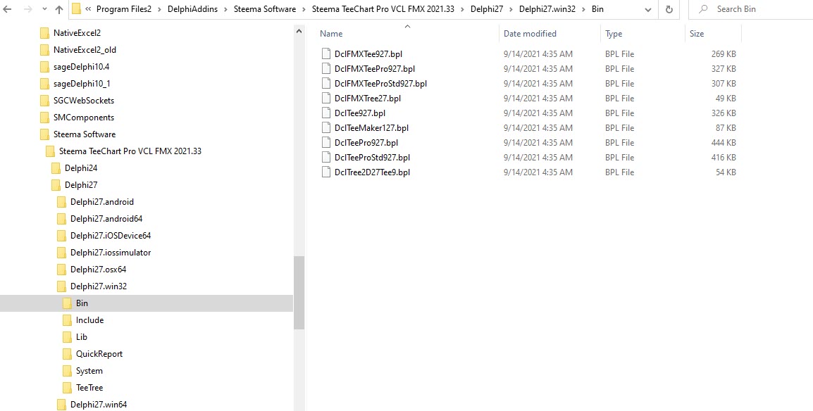

Could you please check if the "Delphi27\Delphi27.win32\Bin" folder contains the design-time packages?

Yes, those packages are there.

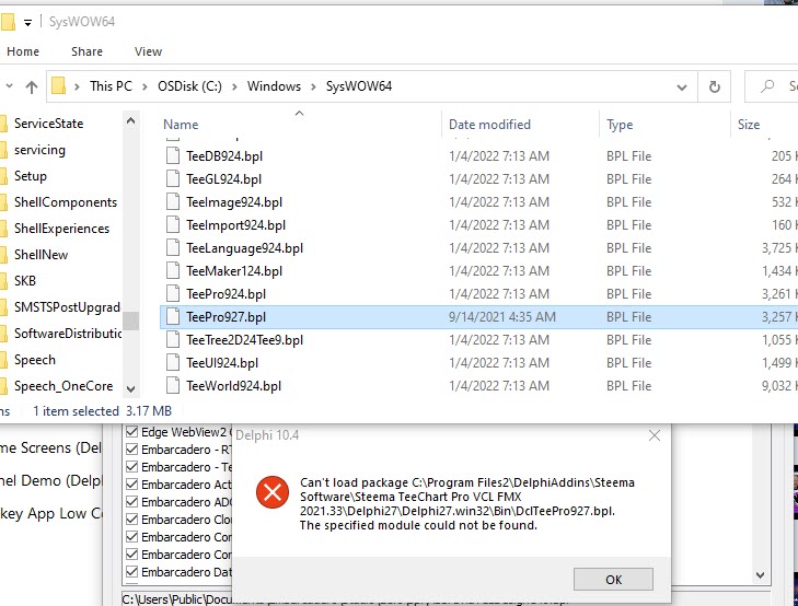

I'd try to install the packages manually. To do so:
- Go to the list of packages ("Component\Install Packages...").
- Click on "Add..." and browse to the design-time package (DclTeePro927.bpl) in the "Bin" folder you showed in the last screenshot.
- If it gives an error saying it can't find the runtime package (TeePro927.bpl), then go to the "Delphi27\Delphi27.win32\System" folder and check if that package exists. If it exists, copy it to the "C:\Windows\SysWOW64" folder. For Win64, also copy the runtime package (TeePro927.bpl) from "Delphi27\Delphi27.win64\System" to "C:\Windows\System32". Close and reopen the IDE, and try to add the design time package again.

I got a "Can't Load package" error so I did as instructed and copied the two "TeePro927.bpl" files to SysWOW64 and System32 folders. I still get the exact same error. I see the 924 files were already there, does that provide any hints?
