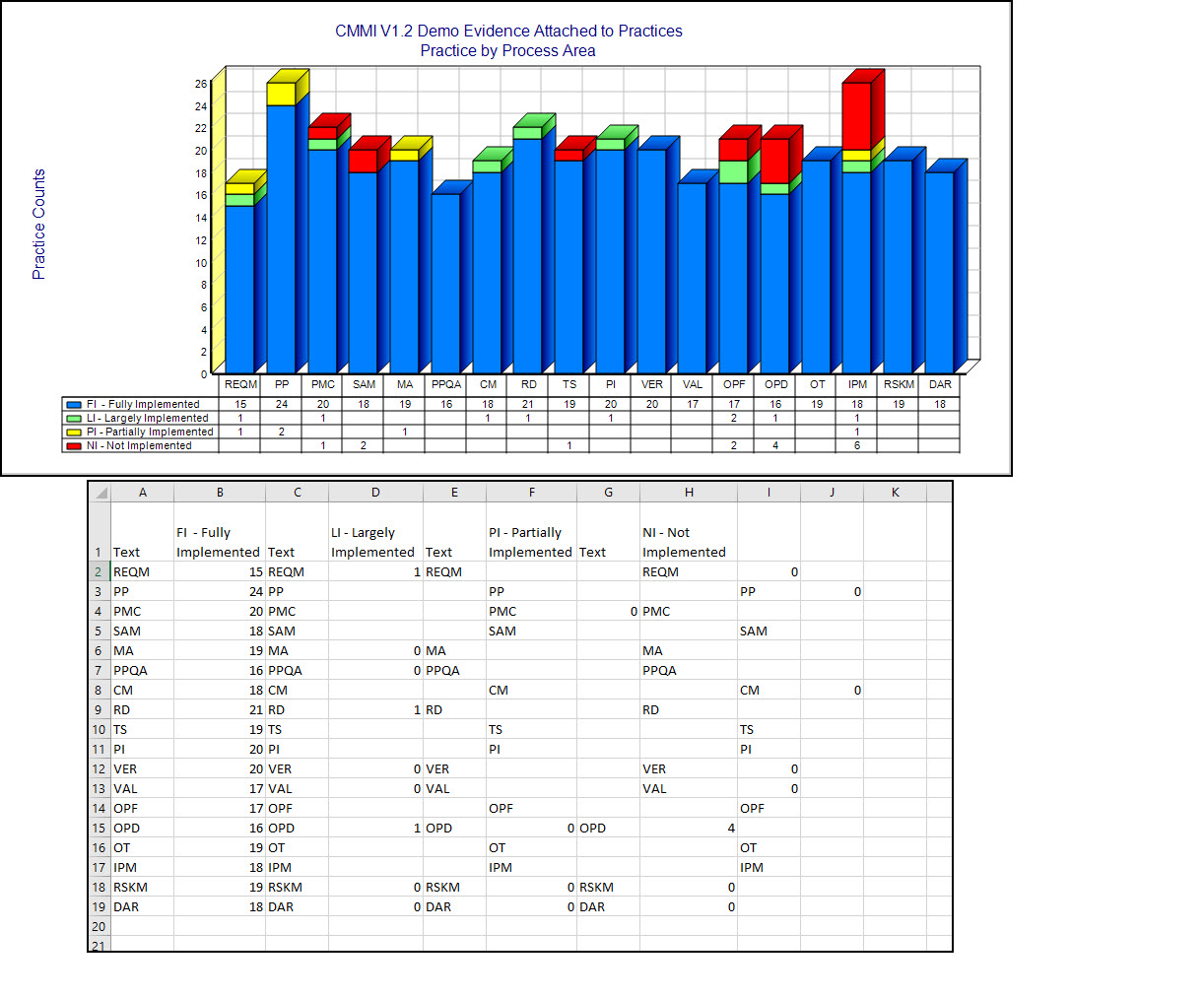

When I export chart data to XLSX some data is lost and some data is offset. In the image attached you can see the values in the data table and what shows up after export. Any ideas how to correct the export.
Mike Simmons
Data incorrect in export to XLSX
- DataExportIssue.jpg (281.02 KiB) Viewed 9843 times

Would it be possible for you to save your chart as a .tee file when run (from editor, export binary include data) and send it to us, to info@steema.com would be fine, and the xlsx exported file too? We'll load the chart and look for possible problems.
If you don't have an editor on the form the quickest way would be to add a TeeCommander bar temporarily for the test run.

Re: Data incorrect in export to XLSX
Hello Mike,
Thanks for the file. We can reproduce the output you've obtained, We see that the older format, xls, saves apparently correctly. We'll work our way through it.
I've logged it asa bug here: http://bugs.steema.com/show_bug.cgi?id=2513
Hello Mike,
I'll check the syntax you have sent over in your last post, to run the older Excel version and reply to this thread. In the meantime just to let you know that issue you reported, logged as #2513, has been fixed.
I see you are a sourcecode customer so I am sending the modified unit to you directly. You should replace it in your source and run TeeRecompile to update the binary version and the vcl unit folder.
