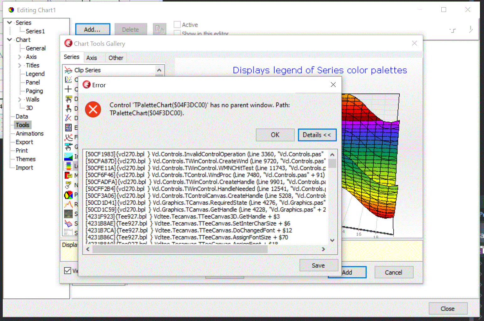

Fresh installation of 10.4.1, only component installed TChart and I still get the error message.

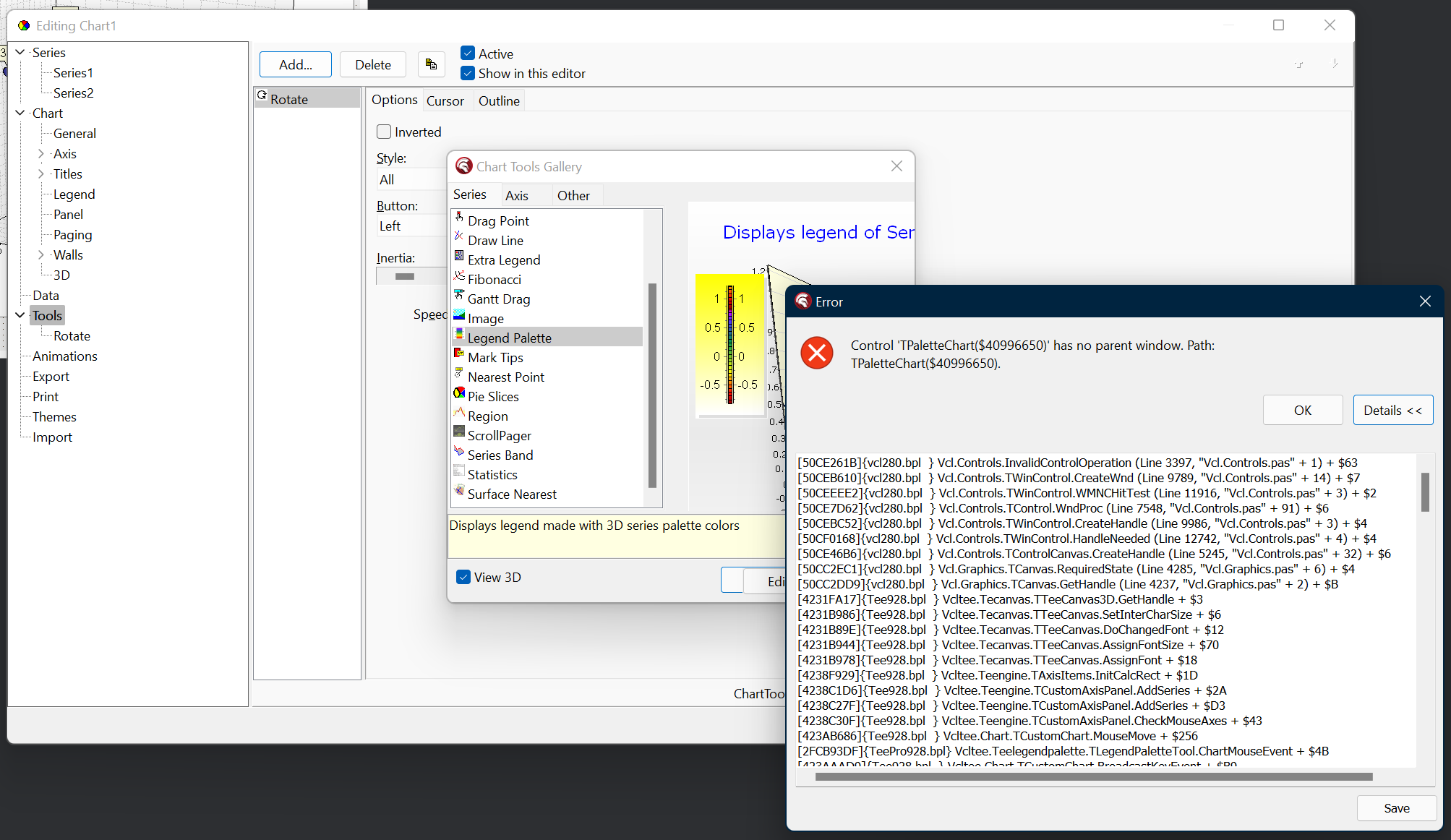

After 2 years, a new fresh Delphi 11 installation and fresh TeeChart installation (latest source code) I still cannot use this tool.
Screenshot 2022-04-26 175250.png (250.14 KiB) Viewed 22044 times

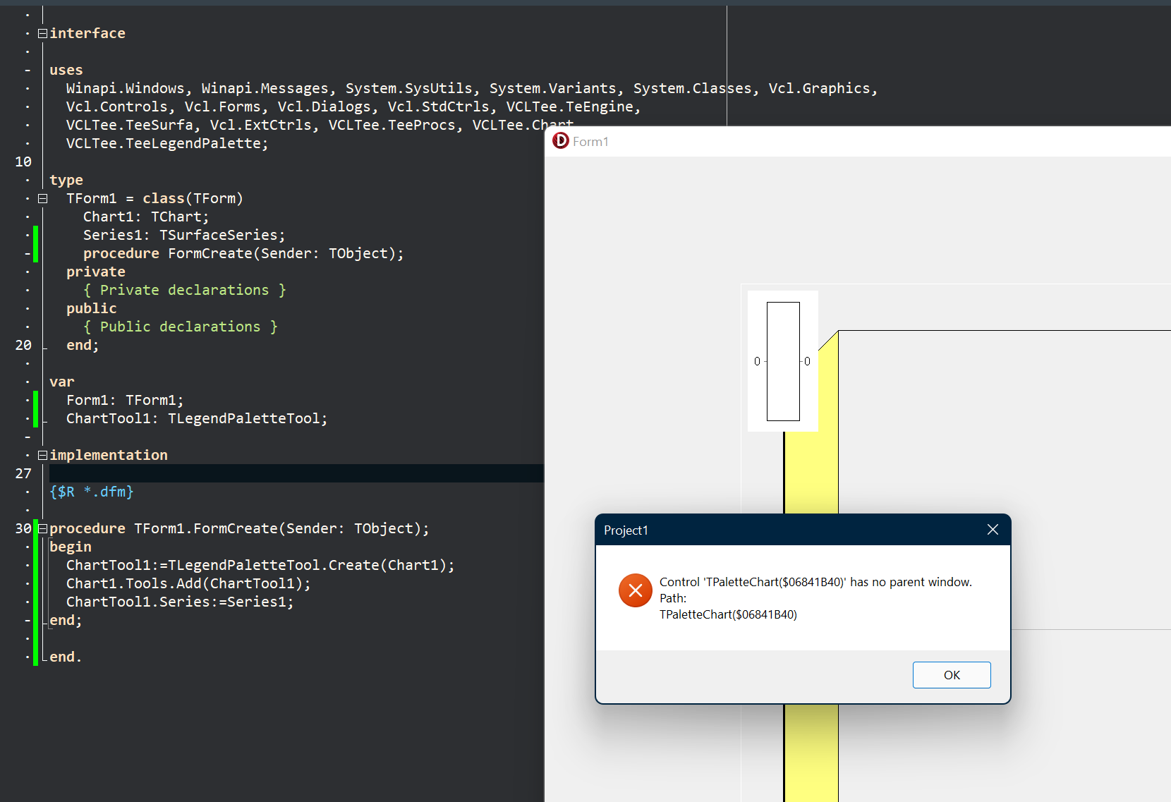

Some time ago I sent you a sample project, here is a new one, it will most probably work ok with you. I need someone to provide some insights on how to succesfully locate the source of the issue.
Unit1.zip
(5.78 KiB) Downloaded 1059 times
Screenshot 2022-04-29 135232.png (75.39 KiB) Viewed 21982 times

Could you please try creating it by code?
var ChartTool1: TLegendPaletteTool;
  ChartTool1:=TLegendPaletteTool.Create(Chart1);
  Chart1.Tools.Add(ChartTool1);
  ChartTool1.Series:=Series1;

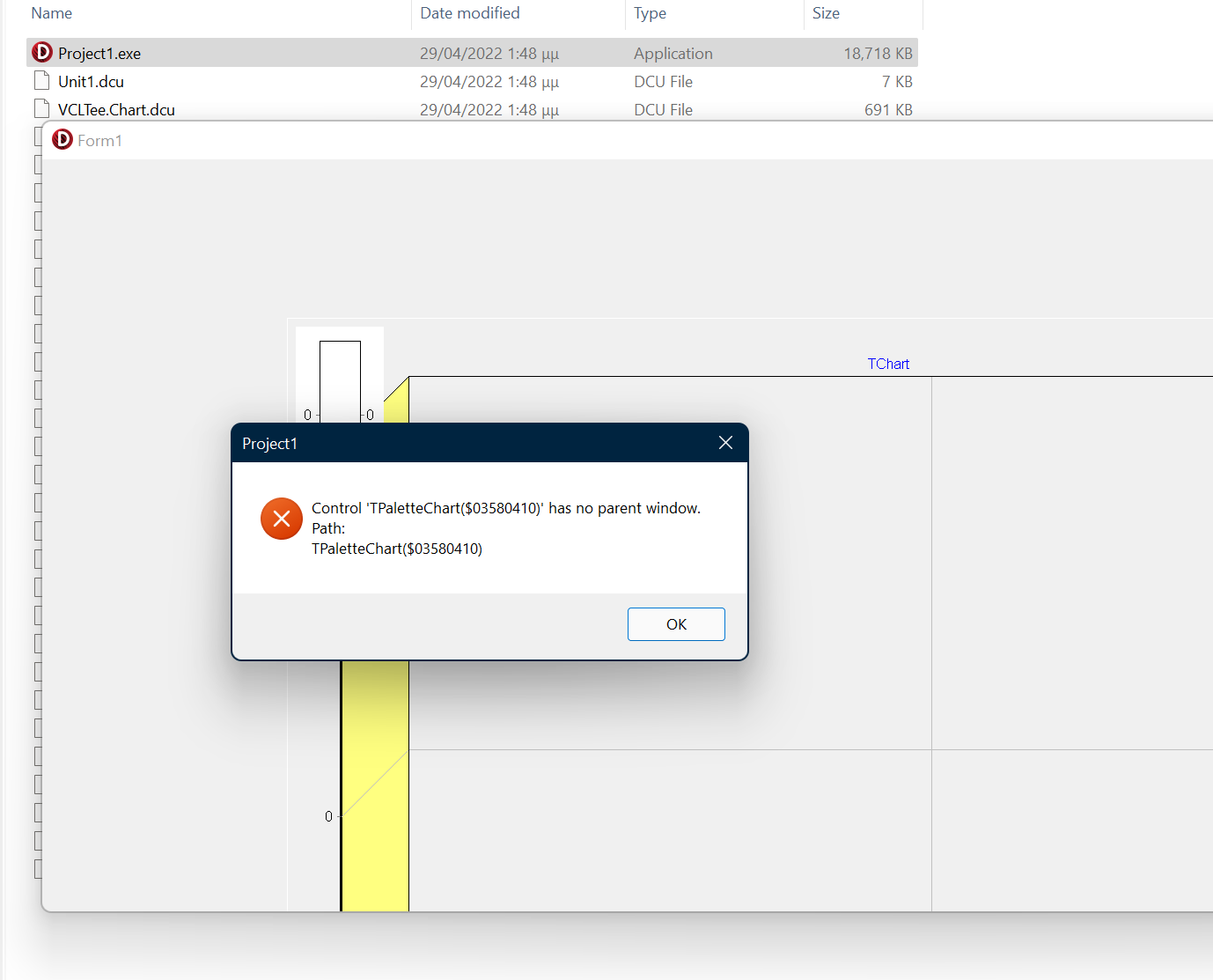

... once the mouse enters the chart area the same happens
Screenshot 2022-04-29 182520.png (122.74 KiB) Viewed 21975 times

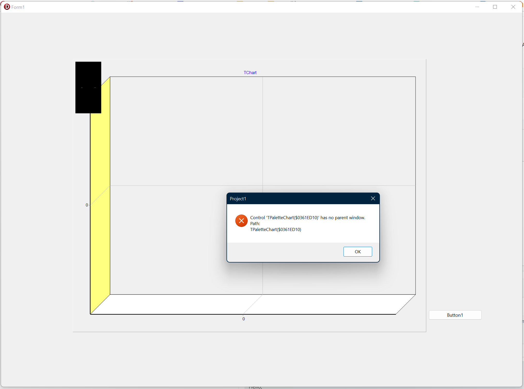

No problem, as I suspected the error is still here! Now what?! :shock:
Screenshot 2022-05-26 174020.png (62.19 KiB) Viewed 21463 times
