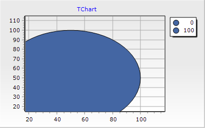

I'm not sure to understand the situation. The shape series is clipped by default in the chartrect so the axes labels are always shown in a simple example for me here:

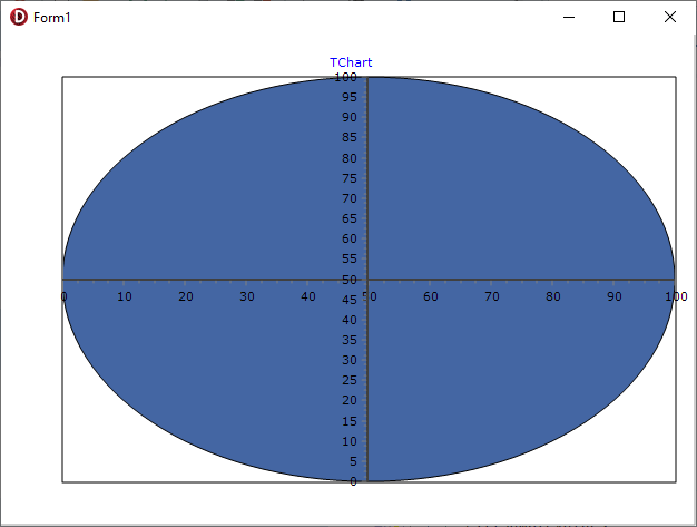

Hello, thanks for the reply. Yeah, that was a little unclear. What I would like to do is have labels in the chart, not just on the outside axis. For example, running down or across the middle of the chart.
Thank you.
Re: Axis Labels Behind Shape Series?
Post by Yeray » Tue Jul 19, 2022 8:19 am
You may be interested on the axes PositionPercent, PositionUnits and the Chart's AxisBehind properties.
Ie:
uses TeeShape;
  with Chart1 do
    View3D:=False;
    Legend.Hide;
    Gradient.Visible:=False;
    Color:=clWhite;
    Walls.Back.Color:=clWhite;
    with Chart1.AddSeries(TChartShape) do
      FillSampleValues;
      Color:=OperaPalette[0];
    Chart1.AxisBehind:=False;
    Chart1.Axes.Bottom.PositionUnits:=muPercent; //muPixels,muPixels;
    Chart1.Axes.Left.PositionUnits:=muPercent; //muPixels,muPixels;
    Chart1.Axes.Bottom.PositionPercent:=50;
    Chart1.Axes.Left.PositionPercent:=50;
    Chart1.Axes.Bottom.Grid.Hide;
    Chart1.Axes.Left.Grid.Hide;
