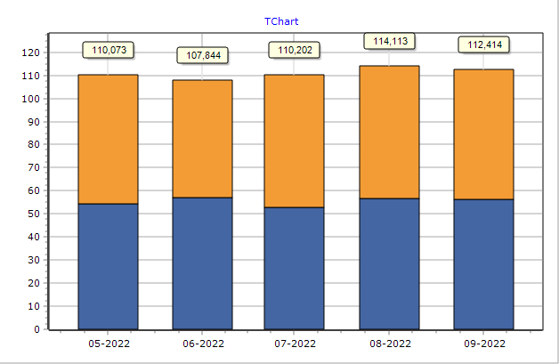

Is there a way to show on graph the total sum on top of every stacked bar column?

Is there a way to format the text values on the X AXis?
My SQL Query shows the X Values on graph like "202205" (YearMonth)
& I would like to show the X Values on graph like "05-2022". (Month-Year)
Thank you in advance
You could use OnGetMarkText event as follows:

There are several options here. If your sql query returns a string, you can convert it to a TDateTime and use it as XValues in the series. Of course this will make the bars to be drawn in irregular spaces if the datetimes are not regular:

Another option is to add that string as series labels. This way you can convert your string from a format to the other before adding the points to the series. Then, the XValues will be regular (0, 1, 2,...).
