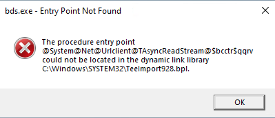

When I open Delphi 11, I get this error
The procedure entry point @System@Net@Urlclient@TAsyncReadStream@$bcctr$qqrv could not be located in the dynamic link library C:\Windows\SYSTEM32\TeeImport928.bpl
I have installed/uninstalled (Run as administrator) several times TeeChartVCLFMX-2022.36.exe Build 2022.36.220929, but it always shows the same error.

However, when opening RAD Studio 11 it still shows the same error:
