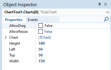

Allowdrag in Tchart as property in tools.subchart
senbengtma
Posts: 15
Joined: Tue Nov 09, 2021 12:00 am
Post by senbengtma » Wed May 10, 2023 2:55 pm
in tools.subchart I can find in the gui "allowdrag" checkbox , but I cant find this for a main chart in a Tform?
Is there a similar property in object inspector or how to do? ( I have unchecked Anchor etd)
Re: Allowdrag in Tchart as property in tools.subchart
Post by Yeray » Tue May 16, 2023 12:48 pm
Indeed, AllowDrag and AllowResize are properties in TSubChart class, not in TChart class.
The TChart can be positioned as a regular TControl. If you leave the Align property set to alNone as per default, then you can position it using Left and Top properties, and size it with Width and Height properties.
