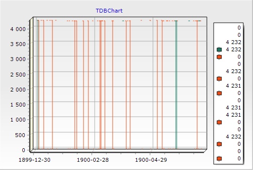

when using seriestext Tosource .. limitied to 2 fields"
When using TdbChart.. data is correct in text in Teechart but not in tdbchart.. see attached jpg
thanks ahead..
chart uncomplete data.jpg (54.88 KiB) Viewed 35663 times
mathsbertil
Posts: 14
Joined: Mon Feb 27, 2023 12:00 am
Re: what is the best way to parse a textfile or from Tmemo
Post by mathsbertil » Mon May 29, 2023 4:00 pm
I dont give input for name and data... only for pricefields
mathsbertil
Posts: 14
Post by mathsbertil » Mon May 29, 2023 4:14 pm
Index Close High Low Open
0 0 0 0 0
1 0 4232 0 0
2 4232 0 0 0
3 4232 0 4233 4232
4 0 0 4235 4232
5 0 0 4234 0
6 4232 0 0 0
7 0 0 0 4232
8 4231 0 0 0
9 0 0 4231 4231
10 0 4
Post by Yeray » Thu Jun 01, 2023 7:29 am
A couple of considerations:
- Those strings use the same character (comma ,) both as DecimalSeparator and as FieldSeparator. You need to change one of them to be able to correctly identify values and fields.
I chose to modify the values from comma , to dot .:
1685311200, 4239.75, 4243.25, 4231.5, 4235.5, 4236.75, 6617, 2197
1685311500, 4235.75, 4237.5, 4232, 4233.25, 4234.6, 2521, 890
1685311800, 4233.25, 4234.5, 4231.5, 4232, 4233.3, 1517, 526
1685312100, 4232, 4233, 4230.25, 4232, 4231.5, 1568, 566
1685312400, 4232, 4235, 4231.5, 4233.5, 4233.525, 1154, 448
1685312700, 4233.75, 4234, 4232.25, 4233.5, 4233.1, 708, 294
1685313000, 4233.5, 4234.5, 4231.75, 4232, 4233.25, 808, 319
- Those date values look strange. If I take one of them and I convert it to date I get 28605 as year:
  ShowMessage(DateTimeToStr(StrToFloat('1685311200'))); // -> 04/05/28605
After correcting those issues, you should be able to do something like this:
var Series1: TCandleSeries;
  Chart1.View3D:=False;
  Chart1.Color:=clWhite;
  Memo1.WordWrap:=False;
  FormatSettings.DecimalSeparator:='.';
  Series1:=TCandleSeries(Chart1.AddSeries(TCandleSeries));
  with Series1 do
    DownCloseColor:=1330417;
    UpCloseColor:=6519581;
  With SeriesTextSource1 do
    Series:=Series1;
    HeaderLines:=0;
    FieldSeparator:=',';
    Fields.Clear;
    AddField('Date',1).OnGetValue:=DateGetValue;
    AddField('High',2);
    AddField('Low',3);
    AddField('Open',4);
    AddField('Close',5);
    LoadFromStrings(Memo1.Lines);
procedure TForm1.DateGetValue(Field:TSeriesTextField; const Text:string; var Value:Double);
  //Value:=StrToFloat(Text);  // -> Correct Date from text
  Value:=IncDay(Today, Series1.Count);  // I'm using this as alternative to the above
  Series1.NotMandatoryValueList.TempValue:=Value;
