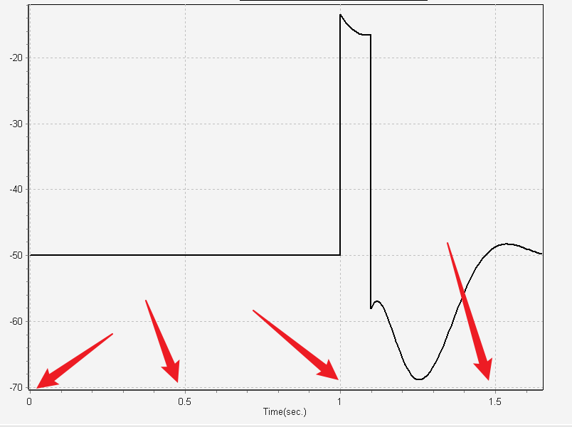

[img]C://Users//lyl//Desktop//222.png[/img]
How to display red numbers on the X-axis???

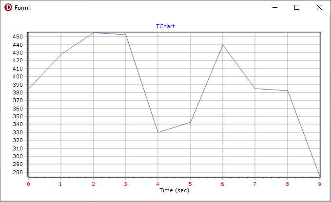

If you want all the labels in the bottom axis to be red you can just set the Bottom axis LabelsFont.Color:
uses Series;
  Chart1.Align:=alClient;
  Chart1.Color:=clWhite;
  Chart1.View3D:=False;
  Chart1.Legend.Hide;
  Chart1.AddSeries(TFastLineSeries).FillSampleValues(10);
  Chart1.Axes.Bottom.Title.Text:='Time (sec)';
  Chart1.Axes.Bottom.LabelsFont.Color:=clRed;

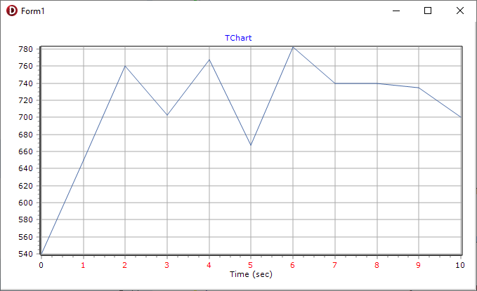

If you want only some labels in the bottom axis to be red, you have two options:
You can use the OnDrawLabel event to change the Bottom axis LabelsFont.Color accordingly:
uses Series;
  Chart1.Legend.Hide;
  Chart1.AddSeries(TFastLineSeries).FillSampleValues(11);
  Chart1.Axes.Bottom.OnDrawLabel:=BottomAxisDrawLabel
procedure TForm1.BottomAxisDrawLabel(Sender:TChartAxis; var X,Y,Z:Integer; var Text:String; var DrawLabel:Boolean);
  if (Text<>'0') and (Text<>'10') then
     Sender.LabelsFont.Color:=clRed
     Sender.LabelsFont.Color:=clBlack;
Or you can use custom labels to achieve the same fine control and the same result. Ie:
uses Series;
var i: Integer;
  Chart1.Legend.Hide;
  Chart1.Draw;
  with Chart1.Axes.Bottom do
    Items.Automatic:=False;
    for i:=0 to Items.Count-1 do
      if (Items[i].Text<>'0') and (Items[i].Text<>'10') then
         Items[i].Format.Font.Color:=clRed;

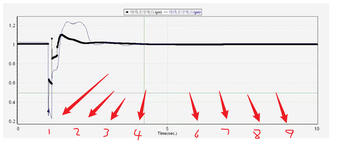

What I mean is that the X-axis now only displays 1, 5, and 10. How to make the X-axis display 1, 2, 3, 4, 5, 6, 7, 8, 9, 10
That is to say, how to make the X-axis display more value text

By default, the Axis Increment is set to 0 which automatically tries to fit as many labels as possible.
Did you change this setting?
You can change it again:
Chart1.Axes.Bottom.Increment:=0;
Or, if you want to force those labels, you can set it to 1:
Chart1.Axes.Bottom.Increment:=1;

[img]C://Users//ly//Desktop//333.png[/img]
This effect is not very good, it should be more. Can you modify your implementation process???
