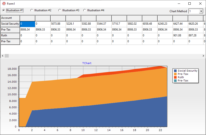

More information: This is income in retirement. The total value of all series increases by about 3% per year, resulting in a smooth line at the top. When income from an account starts or stops, it needs to step up or down, not go at an angle, which would not visually represent the data well.
Does that make sense?

Put another way: for the data, the values increase ~3% for each additional X value. The chart should have a top line that reflects that, and when an account drops off, it should step down; when it begins, it should step up. Does that make sense?

For example, what's the problem with the first one?
You said this about the UpdateChart1 approach:
Test Always #? wrote:
Mon Mar 20, 2023 8:34 pm
UpdateChart1 shows the chart correctly but doesn't do the stepping.
But I don't see the problem.

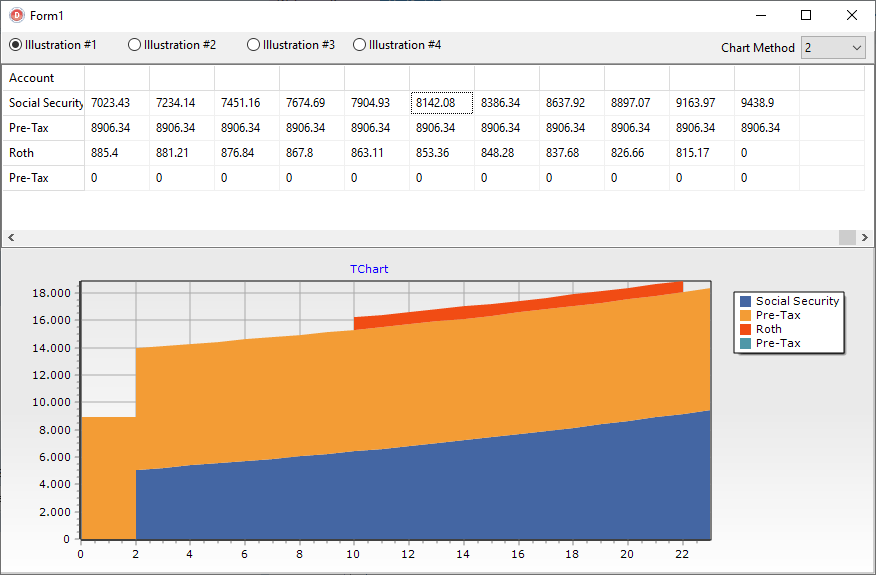

I don't want the angled lines--like the blue line that goes from 1 to 2. It should be a vertical line at 2, and the yellow line as well. It is more of an on/off value, not something that gradually gets there. (This can be done in a bar chart a lot easier, but the area chart communicates better the continuality of time better than a bar, and stepping up/down communicates turning it on/off).

Then, you want illustration #1 to look like in "method 2".
The last down step in the red area is a problem?
If it's a problem, how would you draw it? The sum of data at point x=22 is 9.163,97+8.906,34+815,17=18.885,48, while the sum of data at the last point (x=23) is 9.438,9+8.906,34=18.345,24. So that looks like a down step in the values, isn't it?
