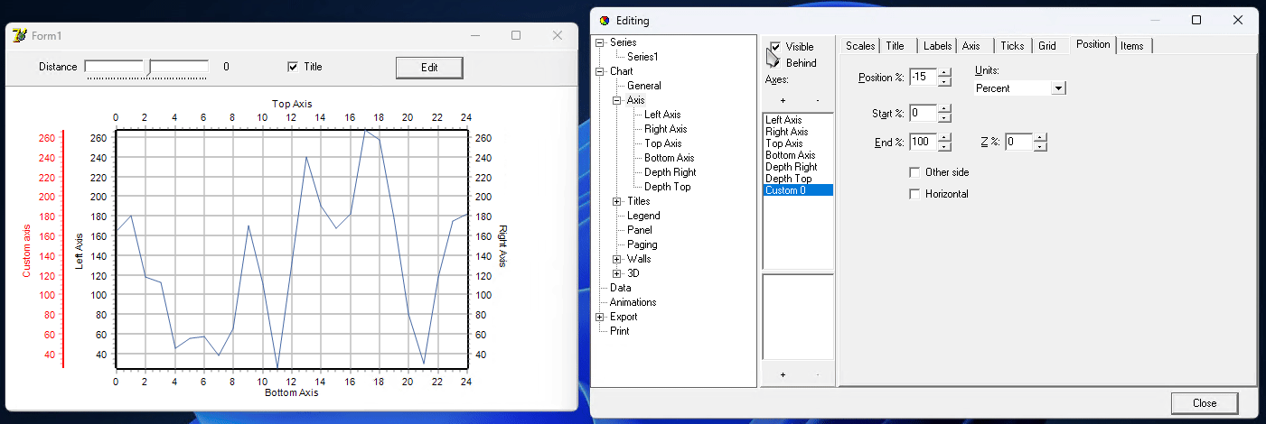

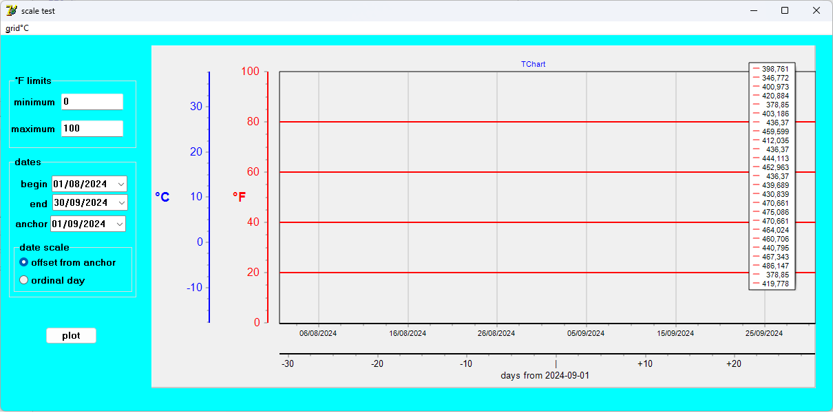

I believe I haven't correctly understood the initial issue.
This is what I see with your example:
So I don't see any axis at the right.
If you want an axis to be at the right side of the chart, you may want to set its OtherSide property to true. This way, the labels and title related to it will also change their side:

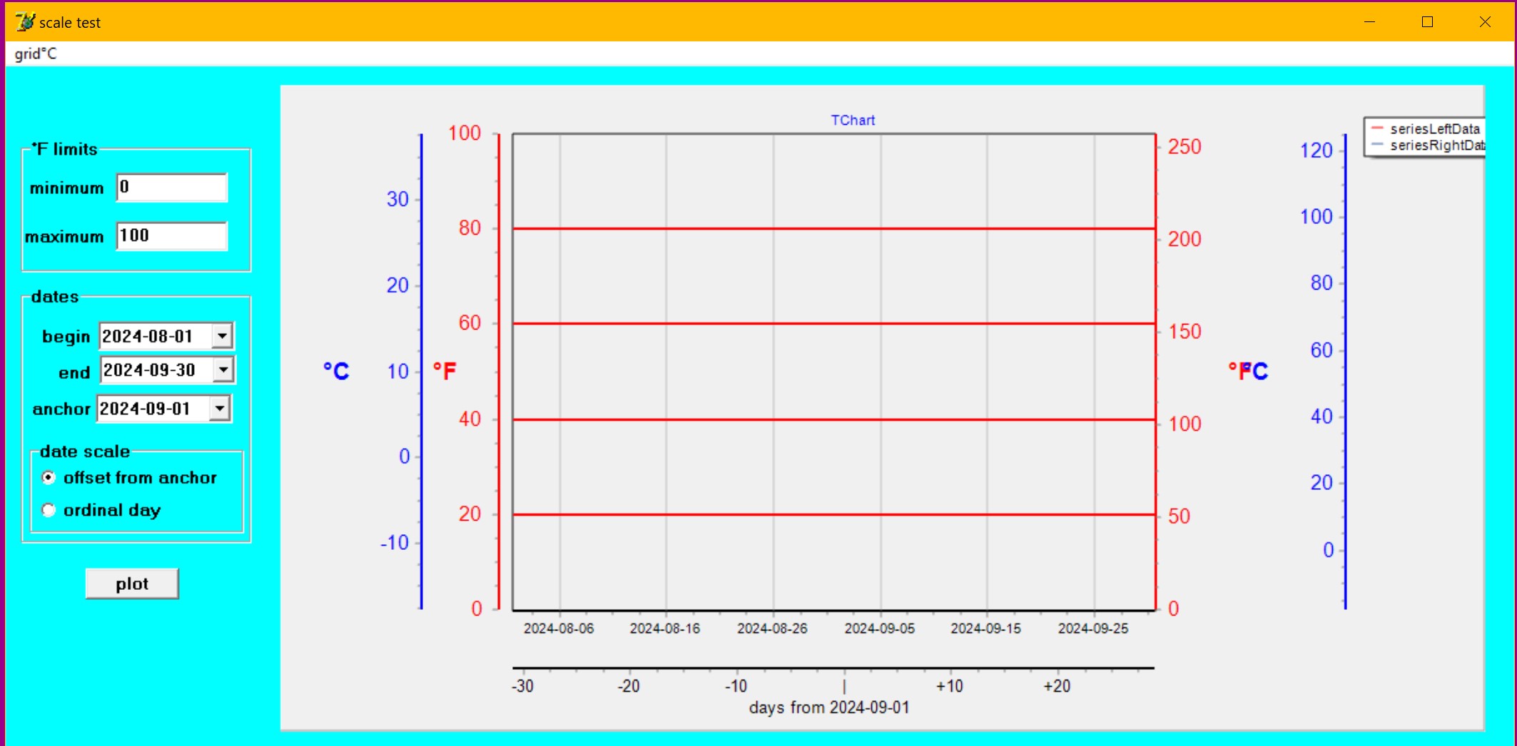

Post by Fenichel » Mon Sep 16, 2024 6:45 am

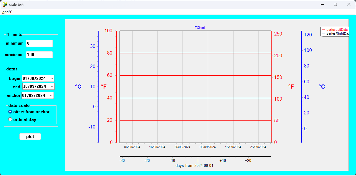

I think you are not looking at the latest version of my demo. When I run it I seeImage
But you're right; I hadn't noticed the OtherSide parameter. Should it be mentioned in the Axis chapter of the tutorial?

Post by Yeray » Mon Sep 16, 2024 9:58 am
Indeed I'm afraid I was looking at the wrong version of your project.
Adding a boolean property (ie OthSide) to your tScale and mapping it to the Axis OtherSice property seems to solve it for me here. Note I also had to modify your OuterPercent peorperty, which maps to PositionPercent:

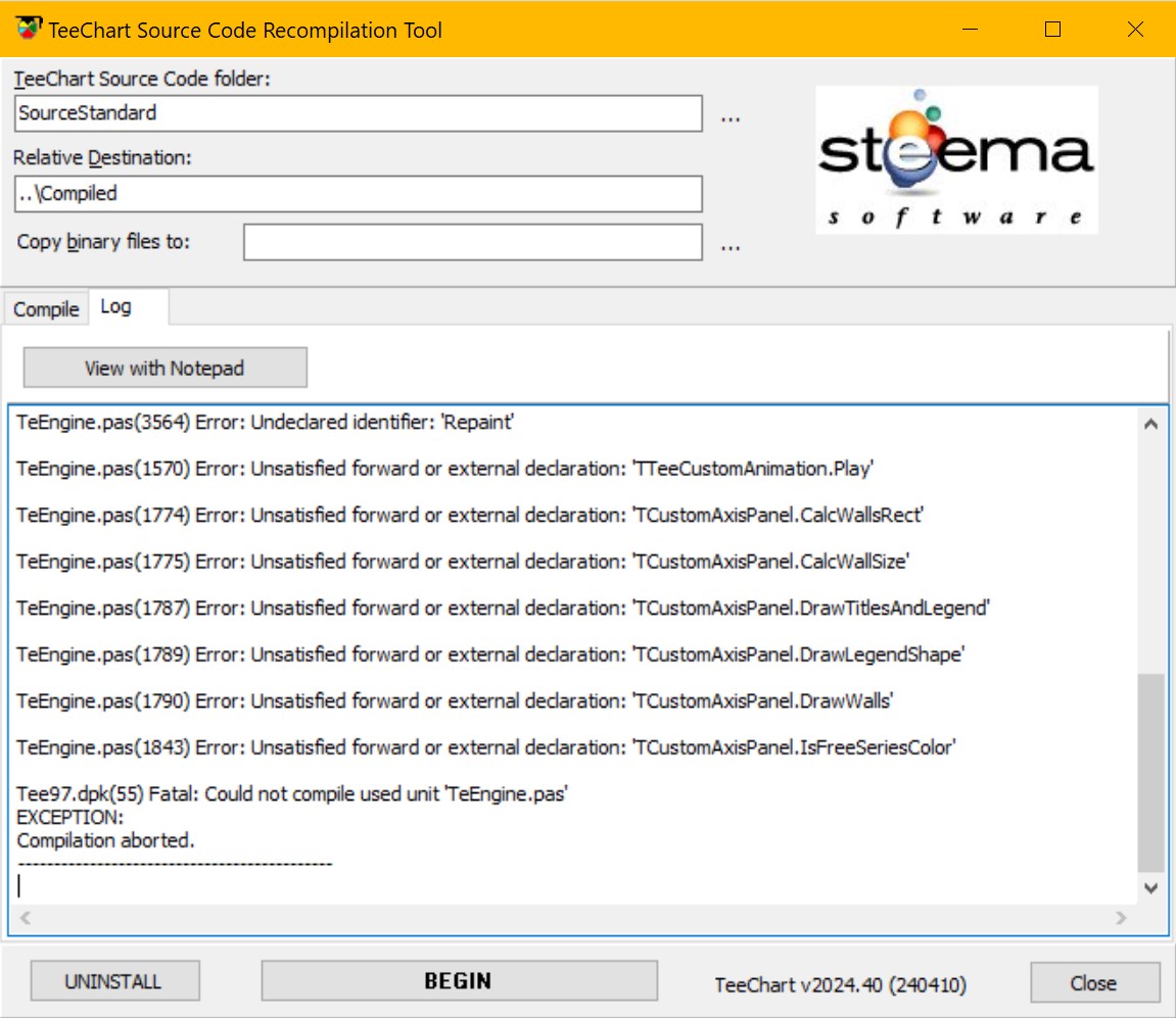

Here is a screenshot of errors from TeeRecompile:
TeeRecompile failure.jpg (199.43 KiB) Viewed 180240 times

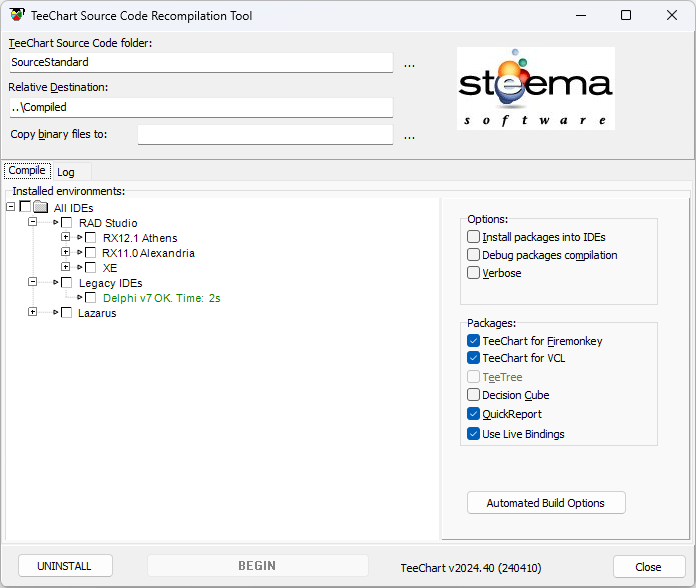

According to the error message (Tee97.dpk), you seem to be compiling TeeChart Standard v2024.40 for Delphi 7.
I've just tried it here and worked fine:
Have you modified those sources to add the new Distance property? Make sure the changes are correct.

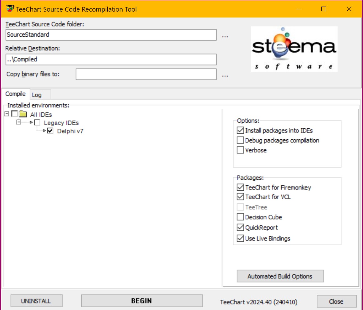

  • Could I be checking the wrong boxes when I run TeeRecompile? Before I click Begin it looks likeImage
Could you put a copy of the correctly-edited TeEngine.pas somewhere for me to download?

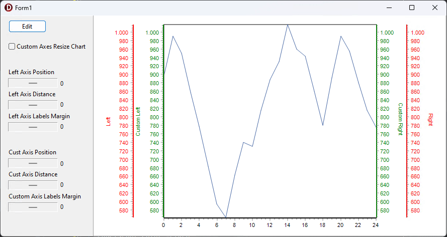

Post by Yeray » Mon Sep 23, 2024 10:51 am
Yeray wrote:
Mon Sep 23, 2024 9:23 am
Manually created axes do have their ResizeChart property set to false by default.
However, setting it to true will cause other side effects.
I'll investigate if there's anything else we can do.
After setting ResizeChart property to true for a custom axis, you can play with the Texts.MarginToAxis as well as the already mentioned Title.Distance and PostionPercent properties to adjust them as you wish:
