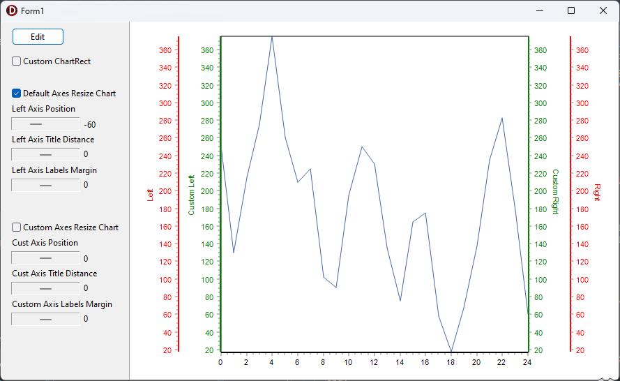

So, with these changes, you can set ResizeChart property to false and you'll see how Texts.MarginToAxis and Title.Distance properties modify Labels and Title positions without resizing the chart:
Note that, when ResizeChart property is set to true, Texts.MarginToAxis moves the Labels, and PositionPercent moves the Axis, but they don't resize the chart. I think we should improve that.
Improved with this change:
