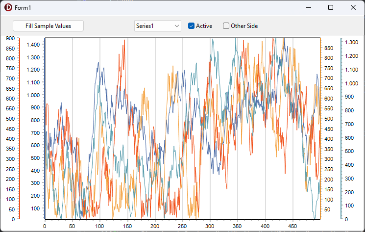

The main concept is that the area in which the signals (aka series) are displayed only takes up the space left by the dynamic number of axes. So, if a file has four channels, each signal in the chart has one axis. The four axes are either to the left side or the right side (or mixed eg. 2 left, 2 right) of the painting area.
The "signal area" takes the rest: Its rectangle's left and right side is the height of the custom axes (Y), the rectangle's top/bottom is the width of the time scale (X, 'bottom axis').
So, inherently, the first data point of a signal (series) is always painted some pixels (borders, padding, margins etc) to the right of the right most axis (if all axes are left), because the Minimum of 'my' X axis starts on the left side of the rectangle of the "signal area".
So are the horizontal lines of a grid.
In the example above, all the series and grids are draw at the right of the right most axis. So as I understand, it fits that description.
However, you replied that wasn't the desired behaviour. I'm getting confused.
I'd suggest to just take "paint" and manually draw how you want it to look like and we'll prepare a simple example.
Two pictures:
One axis: https://www.directupload.eu/file/d/8826 ... oz_jpg.htm
Two Axes: https://www.directupload.eu/file/d/8826 ... 6r_jpg.htm
Rectangles:
A) One rectangle with the curves/signals --> "signal area"
B) One rectangle with axes/scales, width of single axis rectangle identical to others --> "axes rectangle"
C) One rectangle with bottom axis/scale
D) One big rectangle that encloses the entire picture
E) 'Rest' rectangle in the bottom-left corner
Width of one rectangle (B): Font size (height! 90° rotation), length of major tick, some margins ( |<Margin>Title/Fontheight <Margin>Major Tick| )
Width of one axis' rectangle multiplied with number of axes = width of 'axis rectangle'
Height of bottom axis (C): Font size (height), length of major tick, margins analog to the ones of the vertical axes
Left of rectangle "signal area" and "bottom axis" = D.left + B.width
Bottom of rectangle "signal area" and "axes rectangle" = D.bottom - C.height
width of signal area = width of bottom axis
height of signal area = height of left axes
If the number of signals (axes) changes, the width of (B) changes, so that signal area has more or less space (width).
The grid is always painted in the signal area's rectangle only.
All font sizes, margins and rectangle values (left/top/right/bottom, width/height) are pixels MULDIV'd with screen DPI.
In your example (https://www.steema.com/support/viewtopi ... 289#p81015) I do not understand how to calculate the values dynamically if the number of axes changes.
In the example:
...Chart1.MarginLeft:=15;
...Chart1.CustomAxes[1].PositionPercent:=-10;
These values are okay for the current situation, two axes -- the chart gets a margin of "15" (unit? percent? of what?) for its left side and the custom axes are moved with negative relative offset (-10).
Why -10? Because it looked best after testing some values? Or was that value somehow calculated from font size and other parameters?
Is the -10% offset from the width of the chart? If so, if the left margin of the chart changes (15->20) the -10% offset of axes position will result in a different absolute offset (because the width of the chart is smaller than with left-margin=15). So the axes will have a smaller (absolute) width? I want the axes to have a fixed width depending on font size, tick length and margins (distance text to border, distance text to tick lines).
Thanks for your patience! :oops:

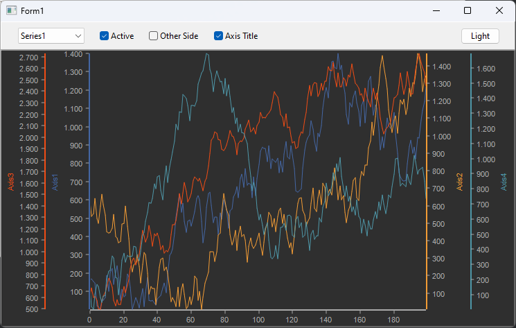

That was a simple example to demonstrate how to place the axes to draw the series without the axes overlapping the series. Of course that could be enhanced.
Here there's a more advanced example which places the axes considering the MaxLabelsWidth, TickLength and adding some extra margin.
AutoAxes.zip
(2.13 KiB) Downloaded 10459 times

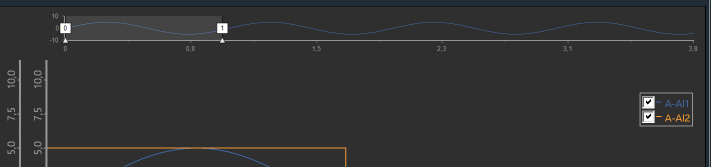

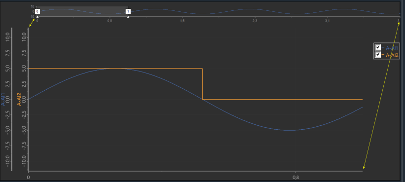

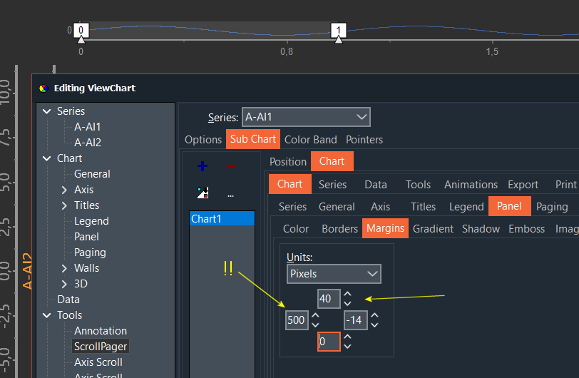

The attached image shows, that the scrollpager's chart is horizontally not aligned with main chart. (Both bottom axes should start at same x position and have the identical length/end position.)
After calling PlaceAxes and adding series to the scrollpager:
ScrollPagerTool.SubChartTChart.MarginUnits := muPixels;
ScrollPagerTool.SubChartTChart.MarginLeft := ViewChart.MarginLeft;
ScrollPagerTool.SubChartTChart.MarginRight := ViewChart.MarginRight;
Ja, that does not do the trick... what do I need to do, to have the scrollpager's bottom axis start and end position at corresponding positions, please?

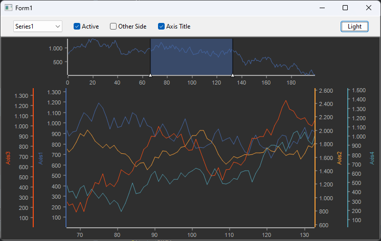

I've made a variant of that AutoAxes example with an improved version of the PlaceAxes function, which is now called at the OnBeforeDraw event.
AutoAxes.zip
(2.41 KiB) Downloaded 16872 times

Any idea about positioning the chart and axes of the scrollpager to fit the requirements in my previous post?
MXHW wrote:
Mon Feb 17, 2025 1:17 pm

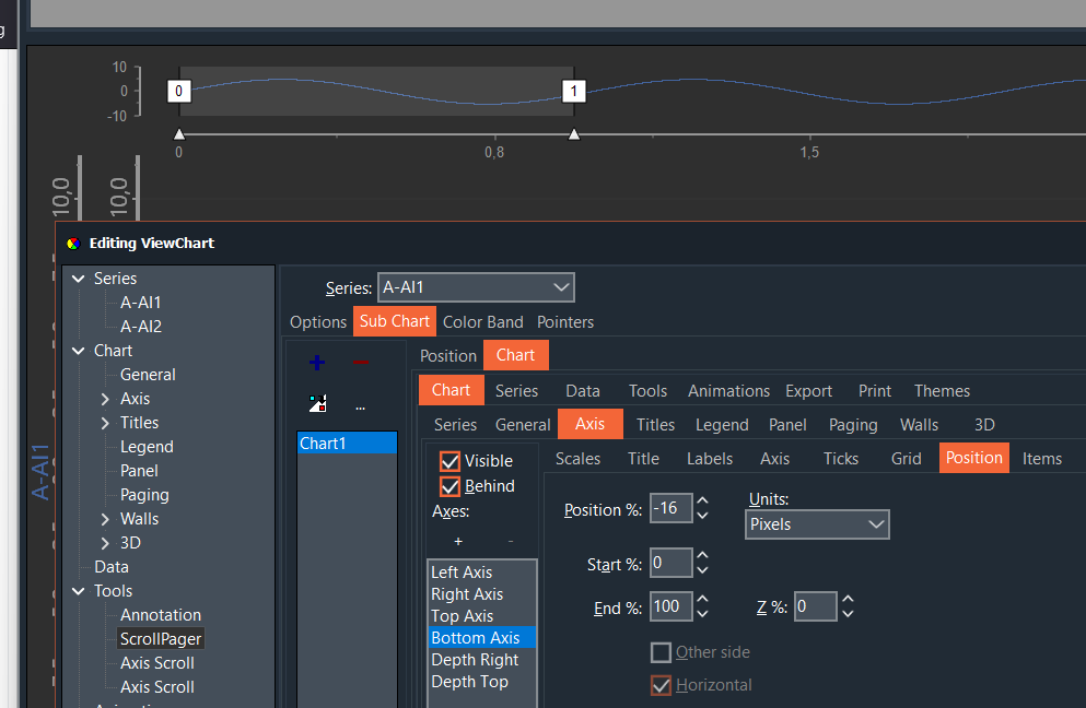

I tried modifying the subcharts panel: margin top and bottom can be modified, but left and right ignore the values set.
The top of the chart 'loses' height with increasing top-margin. Ok, works.
But the left (and) right margin setting ignores any value.
I tried modifying the axis positions.
The left axis can be moved to the left, but the bottom axis vertical position is only movable to the right, because setting "Start %" cannot be negative!
How to align the scrollpager's axes with the ones from the main chart, please?

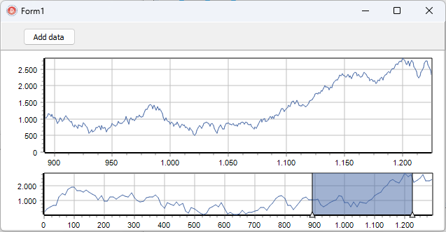

You could set your TScrollPagerTool.Align to saCustom and then set the its positions manually at the same PlaceAxes method:
  with ScrollPagerTool.SubChartTool.Charts[0] do
    Top:=0;
    Left:=0;
    Width:=Chart1.Width;
    Height:=Round(Chart1.Height / ScrollPagerTool.DivisionRatio);
    Chart.MarginUnits:=Chart1.MarginUnits;
    Chart.MarginLeft:=MargLeft-Chart.Axes.Left.MaxLabelsWidth-Chart.Axes.Left.TickLength;
    Chart.MarginRight:=Chart1.MarginRight;
Here the full example:
AutoAxes with ScrollPager.png (51.32 KiB) Viewed 141560 times
AutoAxes with ScrollPager.zip
(2.64 KiB) Downloaded 14621 times

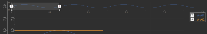

Please examine the position of the Scrollpager: The only difference is, saBefore was changed to saCustom for the Scrollpager's align property:
saBefore
saCustom
In your example the TChart leaves enough space at the top even with saCustom for the Align property, so that the scrollpager's chart fits into the 'gap'.
In my project the TChart does not reserve space for the Scrollpager if the Align property is set to saCustom.
The DivisionRatio property set to 8.0 for saBefore and saCustom scenario.

MXHW wrote:
Mon Mar 03, 2025 10:50 am
Indeed I set the DivisionRatio to 4 and the MarginTop to 100 manually.
Instead, you can set the MarginTop at the PlaceAxes method after calculating the Height of the subchart according to the DivisionRatio.
  Chart1.MarginUnits:=muPixels;
  //Chart1.MarginTop:=100; // <-- don't set the MarginTop at FormCreate
procedure TForm1.PlaceAxes(nSeries: Integer=0; NextXLeft: Integer=0; NextXRight: Integer=0; MargLeft: Integer=0; MargRight: Integer=0);
