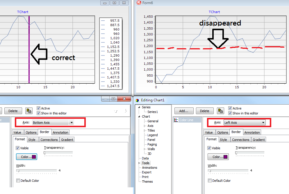

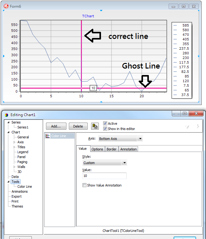

TColorLineTool and TFastLineSeries are heavily used in my project.
There is an extra horizontal "Ghost" line the chart if I set TColorLineTool's axis to bottom,
and there will be no line if I set axis to right.
Please help! thanks.

This is a bug which I have added to the bug list with ID465. This only occurs in 2D charts. If you signup at Steema's bugzilla platform you'll be able to receive automatic notifications about issue's progress.
Re: Strange behavior with TColorLineTool...
Post by Narcís » Fri Nov 22, 2013 2:44 pm
Narcís wrote:This is a bug which I have added to the bug list with ID465.
This has already been fixed for the next release.

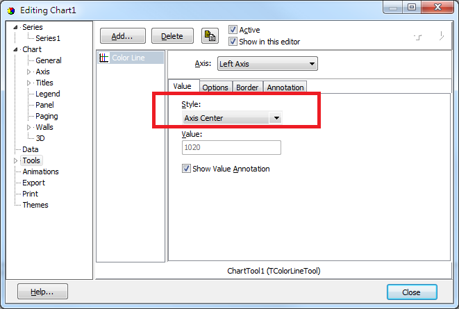

I've checked the fix and found that vertical line problem is solved, but horizontal line does not appear.
Please check the attached picture for detail, Thanks.

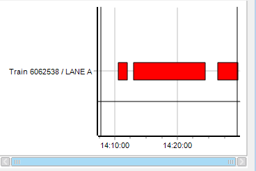

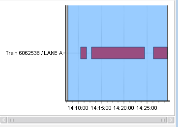

Posts: 8
Joined: Wed Dec 18, 2013 12:00 am
Post by RA Team » Wed Jan 08, 2014 12:38 pm
