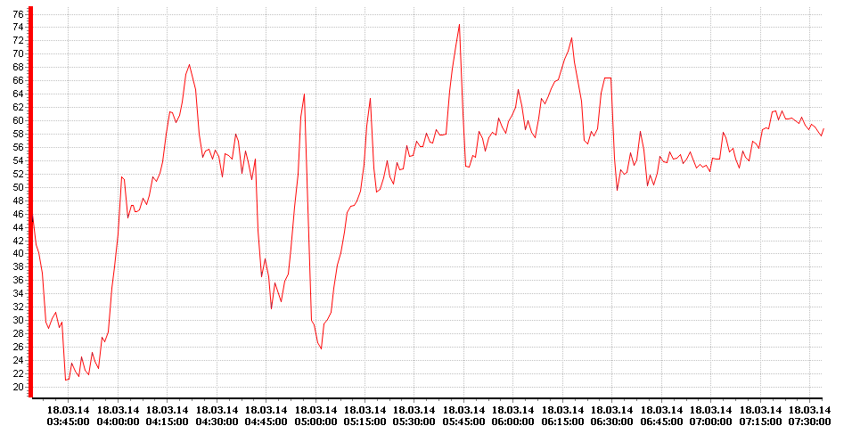

Note the color isn't perfect. This is because our AntiAlias is doing a blending with the background and it gives blue-greyed line.

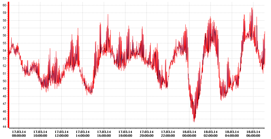

it is better now, but when data is dense and lines overlaps each other it still looks bad.
Can it be fixed like it was in older versions.
Dense data
Data that does not overlap lines is better (actually this kind of data/drawing GDI+ is good)

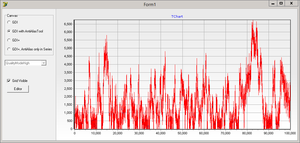

It doesn't look so bad for me only changing the color and the number of values.
Isn't this what you get with the example some posts above and the following changes?
  with Chart1.AddSeries(TFastLineSeries) as TFastLineSeries do
    Color:=clRed;
    //AddArray([10,10,12,1,15,13,13]);
    FillSampleValues(100000);
    BeforeDrawValues:=SeriesBeforeDrawValues;
    AfterDrawValues:=SeriesAfterDrawValues;
On the other hand, having so many overlapping points makes the chart difficult to read. You may be interested on setting the TFastLineSeries DrawAllPoints property to false or reducing the number of points with the TDownSamplingFunction.
