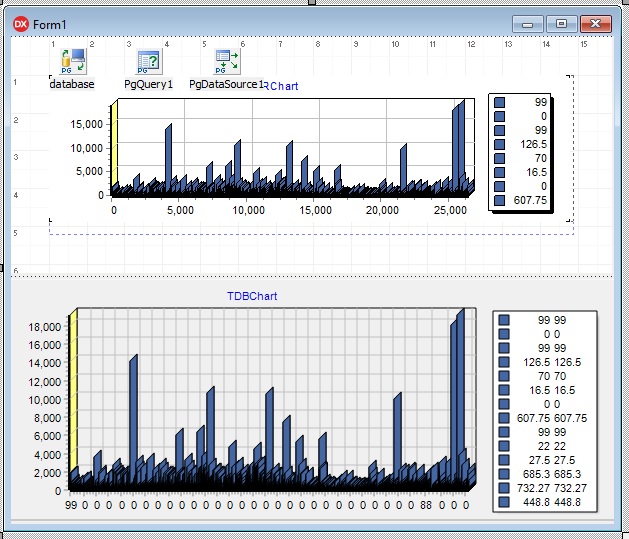

I have had some successes, Everything is as per your instruction Doc, but if i put a copy of both BPL's in the C:\Users\Public\Documents\Embarcadero\Studio\18.0\bpl which is $(BDSCOMMONDIR)\Bpl and install it from that location it will install with no errors.
I used the DclTee9QR506D24 which you sent me, not the DclTQR924 which was installed from the installer.
I can see the chart in quick reports, it has a qrdbchart listed too. And in the series section of the chart the datasource list now shows dataset and the other sources that where missing before. It lists the correct fields in each series as per setup in RAD 2010 which worked.
The program compiles fine, but when it runs the following occurs when the datamodule is created during run time which holds the query for the chart.
I get error message below
exception Class ChartException with Message 'No valid datasource: query1'
The coding is fine in Rad Sudio 2010 and compiles/ runs ok at that point. All i have done is compile it in Berlin which happens ok.
Idea's?

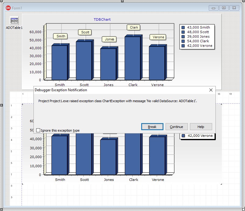

I made a quick project and find that as per attachment that i can get it to display data in both a standard DBChart and a Quick report during design.
It will compile but when it goes to run the app it loads till it reaches the creation point for the form. It will run ok if i remove the series from Quick report and then the standard db will display fine.
- Report Preview.jpg (140 KiB) Viewed 123904 times

I've done a simple example using a TADOTable and it seems to work fine for me here: Does it work fine for you?

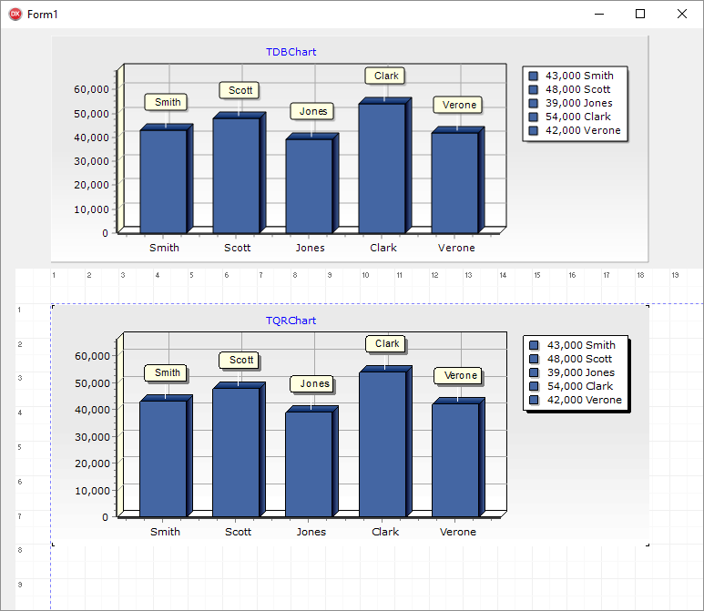

Hi, I tested the project you zipped back. It works during design time, it will compile but when it runs it still says it is missing a datasource

Hi Carl,

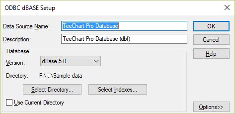

It uses attached database. Which needs to be set like this:

I had hooked it up to a odbc source, error still occurs.
I think you may have missed what i was saying, during design i can live preview the data ok. It will also compile fine. However when the compiled file is run at that point it fails.
The sample odbc database is as per image below is viewable during design, but not when it runs live.
