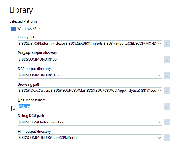

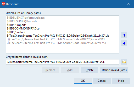

In the list of Library paths, make sure the "Sources\VCL" path is used and not the path to the binary install "Delphi26\Delphi26.*\Lib".
Ie, for win32, this is how I have it to use the binary installation: Note the lines starting with a "dot" aren't recognized and aren't used. I just have them to easily switch between versions.
Also note I use an "Environment Variable" named "TeeChart" $(TeeChart), which I use to point to where I have all the installations (I don't use the default "C:\Program Files (x86)\Steema Software").
If I want to switch to use the VCL sources, I add a "dot" to comment the path I don't want to use and I remove the "dot" from the path I want to use: Also, make sure the "VCLTee" prefix is present in the "unit scope names" ("FMXTee" for FMX projects).

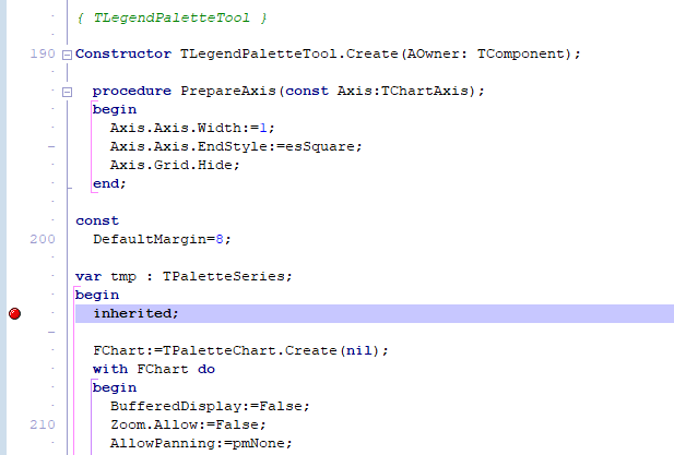

To test the TLegendPaletteTool I would add a breakpoint at it's Create function: When you run the test application, the IDE should stop there, and you can debug. F7 to "Trace into", F8 to "Step over", and F9 to continue running.

I made the change in the Library path but when I try to compile a simple project I get an error at line 98 of VCLTee.TeeProcs: [dcc32 Fatal Error] VCLTee.TeeProcs.pas(98): F2613 Unit 'TeCanvas' not found. I believe this is where I was stuck last time I tried to compile with sources but did not look into it any further, any thoughts of what could be wrong?

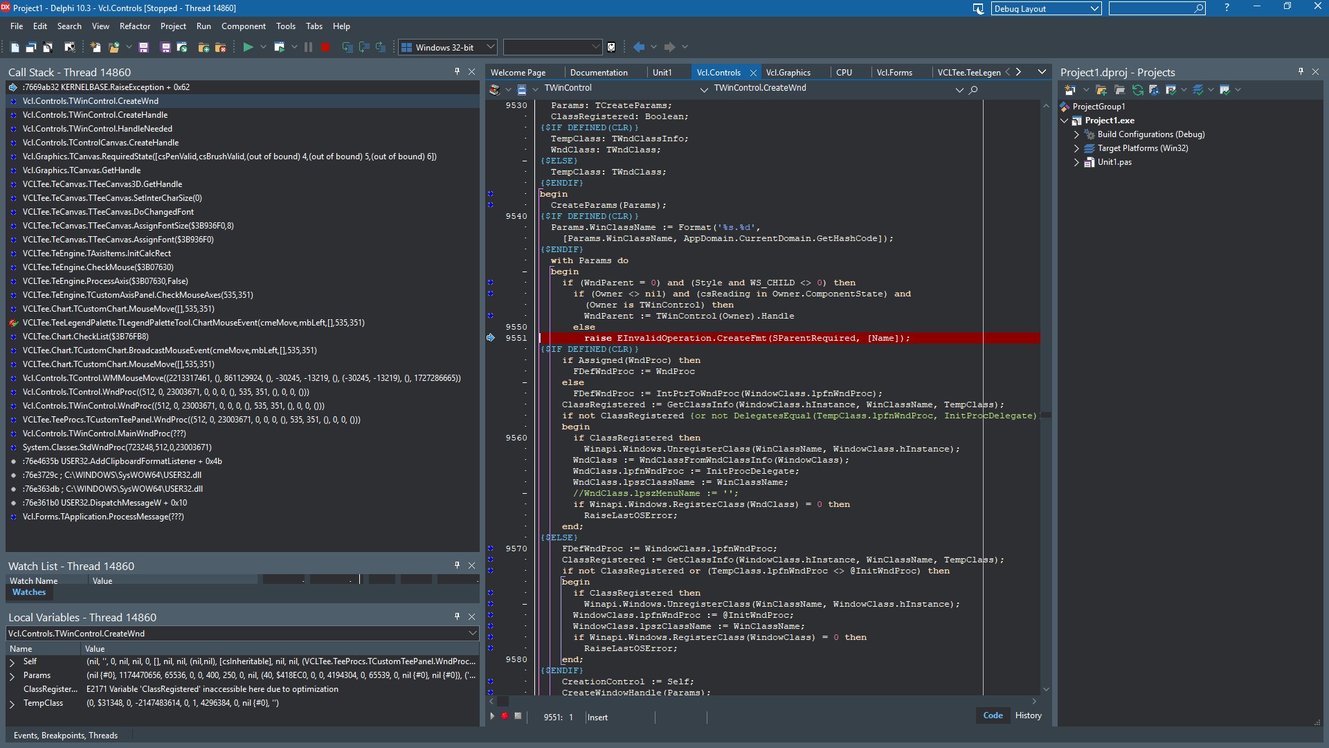

When the exception occurs, you usually can see and navigate through the Call Stack (by default at the top-left corner) so you can see if there is some invalid parameter being passed to some function, or some array being accessed out of its bounds,...
Re: Still cannot use Legend Palette
Yes but unfortunately I do not know how to use this information

I see in your Call Stack the TTeeCanvas.DoChangedFont method is being called while in the example I run here it calls the TGDIPlusCanvas.DoChangedFont method.
So the difference seems to be in the Render option being used GDI vs GDIPlus.
If I change the Render in the "Options\New Chart" to "GDI" in the design time "Options" window, then I can reproduce the error.
So, could you please check if changing that option back to the default GDIPlus solves the problem for you?
