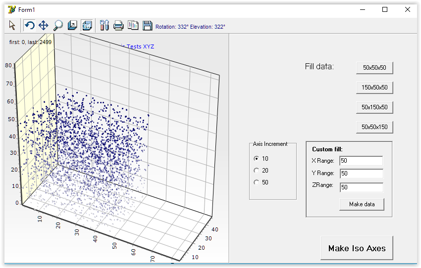

Clicking the "make iso axes" does make the 3D plot isometric but makes inefficient use of the window. If, for example, one uses a custom fill of 50, 50, and 50 and fill data 50x50x50 then the plot is crowded into the bottom left corner and most of the volume of the plot is empty. See the attached plot. Is there an option to have it more efficiently fill the available window while still keeping it isometric?

- Screen Shot 01-11-18 at 08.23 AM.PNG (114.73 KiB) Viewed 21216 times

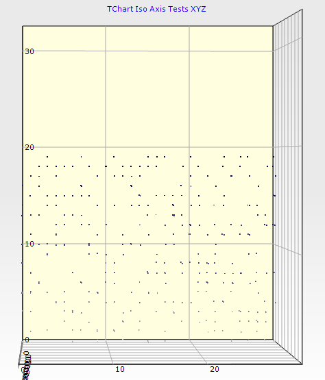

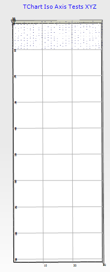

When I looked closer at the demo I see a problem. Am I not using the demo program correctly? I clicked on generate data (I chose values of 10, 20, and 30 for x, y, z ranges) and then clicked on the make iso button. Seems to look ok but if I click on the rotate speed button and then rotate the plot in various directions it become evident that even though the x,y plane seems to stay iso (the grid makes nice squares) the x,z and y,z planes are not iso. The grids make rectangles now even if I click the make iso button again. I used the original binary file that was uploaded to avoid any problems with a recompile on my computer (however the result were identical).
The first attachment is the yz view and the second is the x,z view. I have rotated the view to as orthogonal as possible to the planes. The x,z screenshot looks generally ok but if you measure them they are off.
I would like to get this to work but my users will expect the results to be exact.
- Screen Shot 01-24-18 at 01.16 PM.PNG (13.46 KiB) Viewed 21194 times
- Screen Shot 01-24-18 at 01.18 PM.PNG (9.34 KiB) Viewed 21194 times

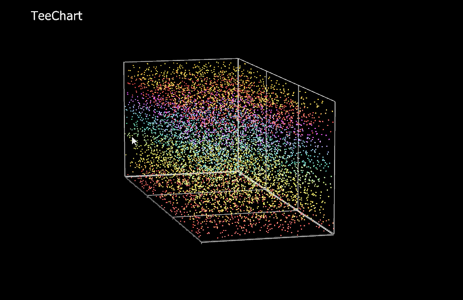

Ok, we'll have another look. Orthogonal did bring down the variables and makes it more controllable but is not true isometric. If we were to fix 120º angles between the planes it would be truer to the definition of isometric projection and would be the only setup at which each plane of equal value have the same physical length on a 2D screen. Rotation would be of that chart. The re-dimensioning of the Chart to take up more space for working values after ISO is applied is an extra challenge.
Example attached.
Example attached.
