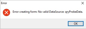

But when i tried to open the form that uses the tqrchart then it errors. See attached image.
This also happens when i made a new app with just the chart on it.

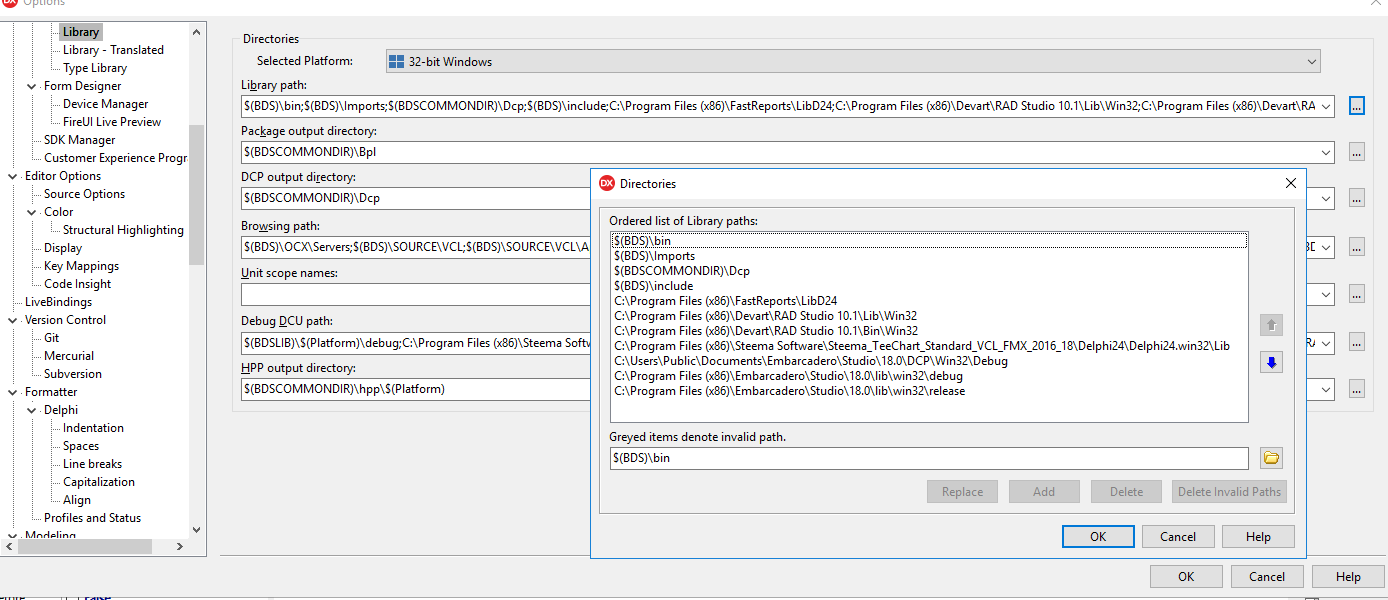

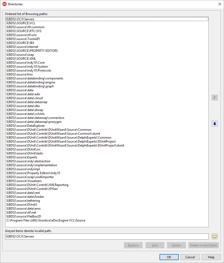

Sorry to say that it was no joy there, same error as previous. I have followed the instruction and then tried various other ways eg... like adding files to the public dcp/bpl folders. but every time it says that a specified module cannot be found. I do wish it would tell me what the module is that is missing though. I have looked at the required units that the compiled versions asked for and they seem to be all there and a single path/file to them too.
I have attached a couple of screen shots of the options library section, is there anything that looks like is missing.

I recently installed on to a fresh Win10 pc that has never had any developing programs on it, Berlin 10 with update 1.
All the 3rd party programs pgDac, Quick Report 6 Pro, Gnostice, including teechart installed correctly with no problems and all work as they should.
So now i try the TQRChart install. The quick report was changed to QRWRunDXE10_1_W64 that was all that was needed. Both the Tee and the DCL compiled correctly with no errors.
I copied the files to the appropriate locations, when i tried to add the package that failed. with the usual specific module not found. Library paths for all units/dcp/bpl where availbale.
I removed all the files from the relevant locations where i had put them and added a file path in the library to the compiled files location.
I was able then to add the package from that location. No Errors at that point.

Hello Carl,
I tried it again a couple of times and I ended reproducing "the specified module could not be found" problem.
Your solution of using $(BDSCOMMONDIR)\Bpl didn't work for me.
I also tried to completely uninstall and reinstall the IDE. This didn't work either.
Then I thought there must be something that isn't correctly uninstalled and I launched the IDE with an option to reset the registry to the defaults:
http://docwiki.embarcadero.com/RADStudi ... nd_Options
Then I could load the DclTee9QR6D24.bpl without problems from $(BDS)\bin again with these packages:
And I can see the "single record" option without problems.
