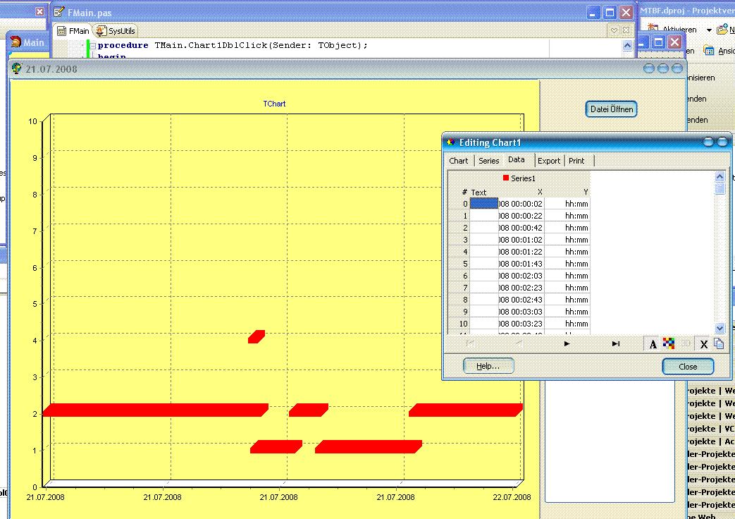

If I add DateTime Values to the bottom axis an open a Charteditor at runtime, the x values are shown correctly but the y values show the DatTime FormatString ('hh:mm') instead of the correct data. y data points are simple integer values.
See attachment.
Any suggestion about that behavior?

Hi Messie,
I see in your project that you've changed you series' ValueFormat from #,##0.### to hh:mm at design time. Note that this is for the YValues, so here it is the explanation of your result.
If you still find problems with anything, don't hesitate to let us know.
