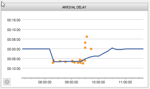

is there any news on this subject? We have a similar issue where having the value information delivered with the OnDrawAxisLabel callback would be really helpful:
We frequently display time values (in the sense of a period of time, or a duration) in a chart, such as a delay. See the image below for an example.
Delay Example.png (9.64 KiB) Viewed 24422 times
As you see, the delay values can obviously also get negative. Unfortunately, the left axis displays the negative times in the same way as positive ones and we have not found any way to change or customise this behaviour.
I was hoping to be able to solve this using the OnDrawAxisLabel callback, but without the tick value I have no clue on how to achieve that.

You can get labels values at OnGetAxisLabel event. Having that in mind you can achieve what you request doing something like this:
uses
  Series;
var i: Integer;
  Chart1.View3D:=False;
  Chart1.AddSeries(TLineSeries.Create(Self));
  Chart1[0].YValues.DateTime:=True;
  for i:=0 to 10 do
    Chart1[0].Add(i-4.5);
procedure TForm1.Chart1GetAxisLabel(Sender: TChartAxis;
  Series: TChartSeries; ValueIndex: Integer; var LabelText: String);
var
  tmpDateTime : TDateTime;
  if Sender = Chart1.Axes.Left then
    tmpDateTime:=StrToDate(LabelText);
    if tmpDateTime < 0 then
      LabelText:='-'+LabelText;

thanks for your prompt answer. The problem of course is that when the initial LabelText denotes a positive value (as in my screenshot), the temp conversion into a TDatetime won't help.
Even when adjusting the DateTimeFormat of the left axis to a fully qualified Date/Time format (such as 'dd/MM/yyyy hh:mm:ss'), it won't properly work, at least for values between -1 and 0. I realise that the problem originates from Delphi's DateTimeToString function.
