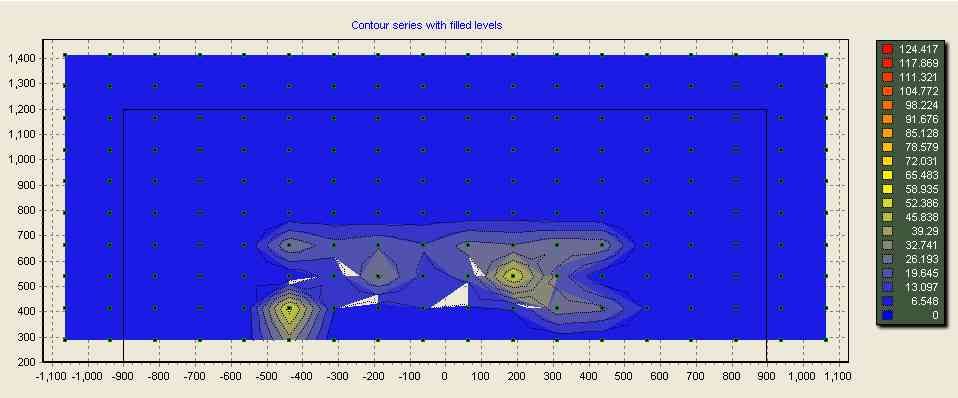

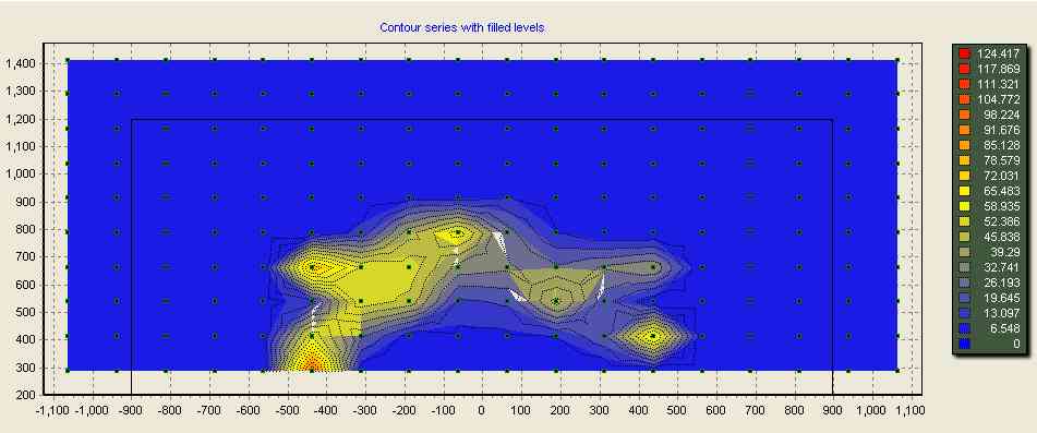

I would like to ask for the status of the known problem with white triangles and difference in isolines and color regions in the contour plot.
I investigated that this issue has been mentioned here a long time ago. But even in the 2010beta (Delphi7) of TeeChart there is still the same problem.
My problem is that I really need this contour plot in my project, but it is not a very professional output with these white triangles.
And this effect is visible in nearly ever real world data set.
So please could the support team supply me the status or even better a solution for this problem?
Bye,
Dirk

Hello Dirk,
The thread references you posted are up to date. This is a complicated issue to resolve. It's high on our priority list but we haven't a solution to it besides completely redesigning Contour and IsoSurface series. We will keep working on the issue for next releases.

Re: Contourplot with white triangles ...
We haven't closed the bug ticket yet and more changes still need to be studied to get a final solution for the TContourSeries. But we've implemented some modifications to the TIsoSurfaceSeries and it seems to be drawn without the white triangles.
Here it is the code that reproduces the white triangles problem with v2011.03 but seems to work fine with the actual sources:
