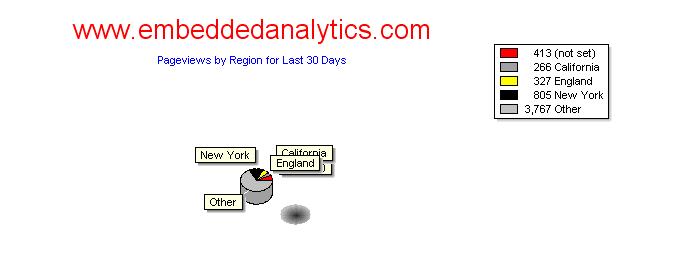

I am finding if my series has a lot (i.e. ~100) of data points and I use the "OtherSlice" property to reduce the number of slices it shrinks the entire chart. Everything else is working (i.e. data points not making the otherslice value are placed in the "other" slice).
Here is an example where I use "OtherSlice" against ~100 data points:
Shrinks File

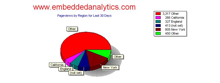

Here is an example where I aggregate myself, reducing down to 10 points:
Good Rendering
