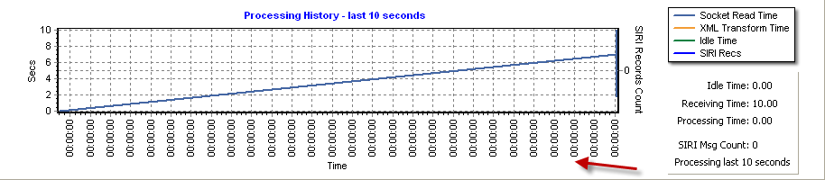

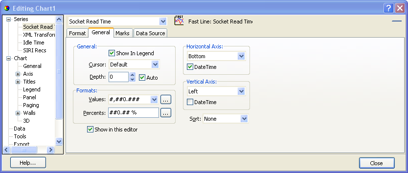

Thanks Narcis, but I already tried that, still there is only zero on the H axis:
IdleProcessingTimeArray : Array[0..255] of Double;
SocketProcessingTimeArray : Array[0..255] of Double;
XformProcessingTimeArray : Array[0..255] of Double;
chart1.Series[0].Clear;
chart1.Series[1].Clear;
chart1.Series[2].Clear;
chart1.Series[0].XValues.DateTime := True;
Chart1.BottomAxis.DateTimeFormat := 'hh:mm:ss' ;
chart1.Series[0].ADDArray(SocketProcessingTimeArray);
chart1.Series[1].AddArray(XformProcessingTimeArray);
chart1.Series[2].AddArray(IdleProcessingTimeArray);
Many thanks for any suggestions

That's normal because you have Integers as DateTime in the XValues and you are formatting them as 'hh:mm'. Let me explain:
There are two AddArray methods available. Here there are their definitions:
As you are using the first one, only adding the YValues, the XValues are 0, 1, 2, 3,... and translating them to DateTime, it's "30/12/1899 00:00:00" for the 0, "31/12/1899 00:00:00" for the 1,...
And formatting these DateTimes to 'hh:mm', you always get "00:00".
So I'd recommend you to use the second AddArray method.
Function AddArray(Const Values:Array of TChartValue):Integer; overload;
Function AddArray(Const XValues, YValues:Array of TChartValue):Integer; overload;

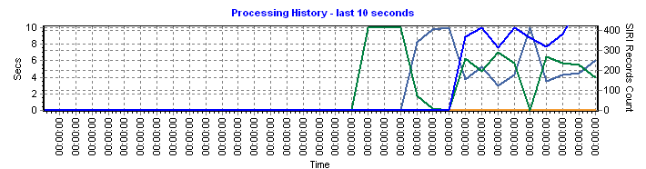

Thank you Yeeray, but still the problem exists
I am now using the overload method
RecAtTimeArray : Array[0..255] of Double; // (stores 'Now')
IdleProcessTimeArray : Array[0..255] of Double;
//move other values down like before then add new value:
//Each time I update the array I add the date time as well in the second array
RecAtTime(high(recAtTime)) := Now;
IdleProcessTimeArray(high(IdleProcessTimeArray)) := IdleProcessTime;
Chart1.Series[0].Clear;
Chart1.Series[0].AddArray(RecATTimeArray, IdleProcessTimeArray);
I think the system adds multiple time stamps (255 of them) for each and every IdleProcessTimeArray array point
Result shown. Many thanks for your support

Any idea anybody how to show a graph and place my own time values for each point on the horizontal axis?
Re: Showing timestamp on Horizontal axis with AddArray
OK, I worked it out
I must user the overloaded method for every series I add to the chart
Series1.AddArray(RecTimeArray, MyData1Array);
Series2.AddArray(RecTimeArray, MyData2Array);
Series3.AddArray(RecTimeArray, MyData2Array);
Adding any series, (not just the one set for XValues.DateTime := True), without adding both arrays, regardless of the order they are added (first, last etc), stops the time display working (shows all zero's).
