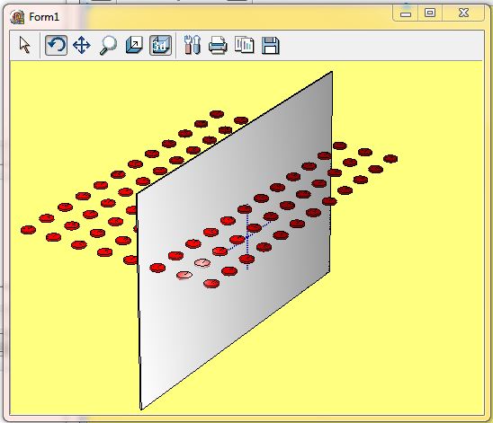

based on some 3 dimensional information I draw a plate and on top of it pie charts in certain X.Y postions.
The X,y postions for the Pie charts are enforced/aligned using TChart.ChartRect.
In previous versions of TChart (like V8.06) the Pie charts were aligned along the X, Y plane now the pie charts are
oviously aligned differently. Is there any fix for that?
Attached there is a small example application that shows the problem.

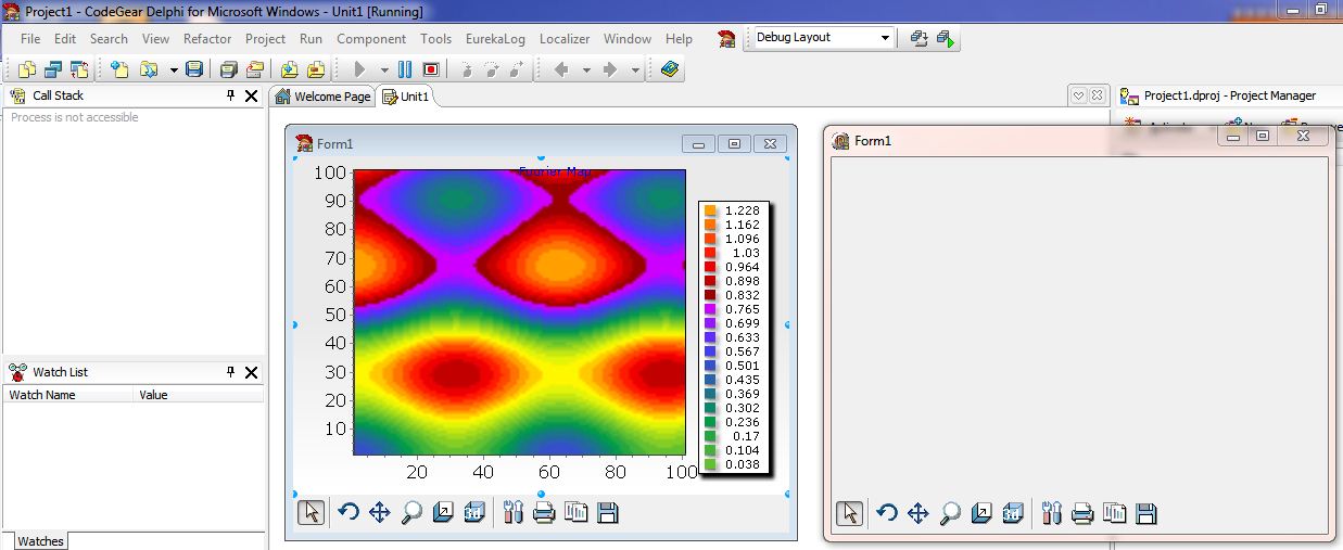

I created an example application to show the Colorgrid bug.
Design time in Delphi 2007 the cologrid displays fine but the executable shows nothing (Of course after populating the the color grid series with random data!)
Attached you find the example project and the compiled executable.
best regards,
X-Ray

Hi X-ray,
I've seen that in your dfm there is the following line:
Deleting it I can see the chart, and adding some values to the ScanColorGridSeries, I can see it without problems.
Visible = False

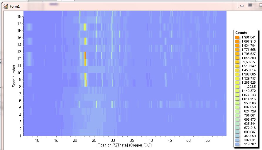

you are right concerning the example application. This is the problem there but the real problem in my applcation which occured after installing the maintenance release persists as you can see on the previous sceen shot where the axes are both visible but the data is invisible. So still left with the work to create an example application to isolate the bug.
I tried it by saving a .tee file but this also doesn't help to show this bug. But it does show another one. The graphics extends beyond the Y axis (you can see that by loading the attached .tee file): You didn't answer the question concerning the 3D alignment bug?
best regards,
X-Ray

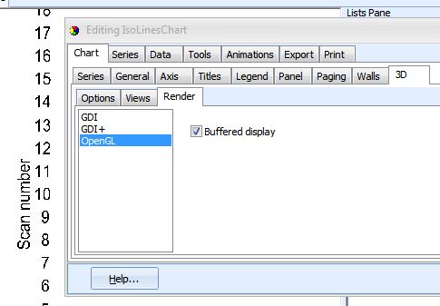

I think I have found the cause for the painting problem. For different series I am using different painters, for 3D surfaces I am using OpenGL and for the ColorGrid I am using GDI. When I am switching to the ColorGrid plot I am switching the Active property of TTeeOpenGL component to False. With the new TChart version this leaves the active Renderer still on OpenGL and no data is shown. When I select GDI in the chart editor form the ColorGrid displays nicely.
Here are my remarks/questions:
1) De-activating the OpenGL renderer should automatically activate the normal GDI rendering again (like in all old versions) and not show an empty screen.
2) How can I programmatically (in code) switch the chart painting back to GDI (as a workarround)?
best regards,
X-Ray

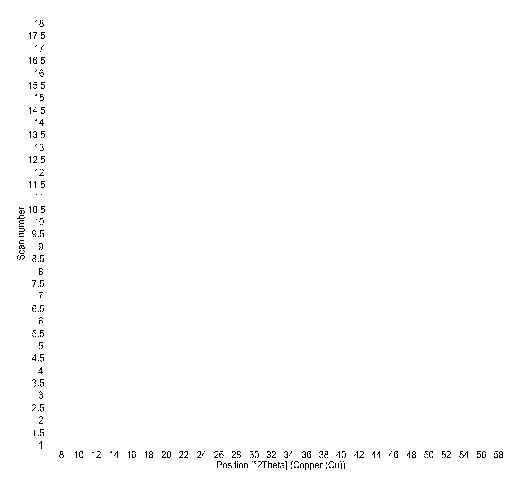

for your convenience I have modidied the example application to show the problem.
Just press the button on the bottom that will switch the OpenGL component to active and the graphics dissapears (why anyway, is this another bug? ).
Then press the button again which switches the OpenGL component active property to False.
You will see that the graphics is still invisible unlesss you select the GDI renderer in the Chart editing form.
best regards,
X-Ray

Hi X-Ray,
TV52014983 hasn't been fixed yet and I can't think of a workaround for now.You didn't answer the question concerning the 3D alignment bug?
This can be solved setting ClipPoints to true:The graphics extends beyond the Y axis (you can see that by loading the attached .tee file):
IsoLinesChart.ClipPoints:=True;
I'm afraid this is a bug which I have added to the defect list with ID. TV52015159.1) De-activating the OpenGL renderer should automatically activate the normal GDI rendering again (like in all old versions) and not show an empty screen.

Re: PieChart 3D alignment
Hi X-Ray,
Ok, I have increased TV52014983's priority to be fixed ASAP.This is a big problem, we going to release a new version of our SW package soon. And now it seems like I have to redo all modifications
and go back to a previous (working) TChart Version (8.06).....
This is because the chart is in 2D mode, code below does the trick.Another question was why the graphics dissapears (the axes are still shown) when I switch to OpenGL mode?
TeeOpenGL1.Active := not TeeOpenGL1.Active;
if TeeOpenGL1.Active then
IsoLinesChart.View3DOptions.ZoomFloat:=100;
IsoLinesChart.View3D:=True;
Button1.Caption := 'OpenGL Active = True'
end
Button1.Caption := 'OpenGL Active = False';
//Workaround
//IsoLinesChart.Canvas:=TTeeCanvas3D.Create;
IsoLinesChart.Draw;
