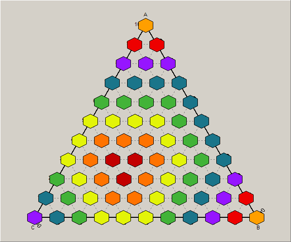

Hi, Yeray and others --
I've created a little demo project (with a runnable EXE and all the source code) that illustrates several tweaks needed to TERNARY plots, including:
* obscuring of axis labels
* clipped display of lower two VertexTitles
* Palette seems to cycle over and over, rather than fitting to the range of values
* addition of a second series makes the first series transparent to axis labels and grid (either that or else the labels and grid are now dran after the frst series)
* demonstration of a nasty bug when setting VertexTitles to an empty string
* colors assigned differently if "ProcessMessages" is used between adding points
The attachment feature here won't allow a zip this size, so I've put it on my server at this address:
http://www.shsmedia.com/temp/TernaryTweaks.zip
I'm looking forward to your comments!!!
Kevin

KevinKillion wrote:* obscuring of axis labels
KevinKillion wrote:* addition of a second series makes the first series transparent to axis labels and grid (either that or else the labels and grid are now dran after the frst series)
These two points I think are caused for the particularity of the series and how are drawn the axes for this series. All this will be revised with (TV52015067).
KevinKillion wrote:* demonstration of a nasty bug when setting VertexTitles to an empty string
I've added the description of the problem in the ticket (TV52015069) that will try to improve the VertexTitles.
KevinKillion wrote:* clipped display of lower two VertexTitles
Yes, this is another of the things we'll try to improve in (TV52015069).
KevinKillion wrote:* Palette seems to cycle over and over, rather than fitting to the range of values
Yes, it seems strange to me too. I've added it to the defect list to be revised in future releases (TV52015092).
KevinKillion wrote:* colors assigned differently if "ProcessMessages" is used between adding points
I can't see any difference. I've tried simplifying your example to the following but I can see the same in the two pictures exported:
