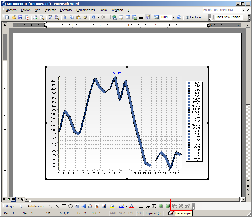

I've found the unGroup button but it is unavailable for me while the image is selected:
Word 2003.png (64.76 KiB) Viewed 7350 times
Am I doing something wrong?

"I've found the unGroup button but it is unavailable for me while the image is selected:"
That is strange because I get this (after paste and select image):
Dag

We've seen that your chart seems to be pasted into some other object, maybe a TextBox?
I've inserted a TextBox and pasted the chart into it. Then, in the TextBox contextual menu (not in the Chart image contextual menu) I can see the Group submenu, but all the buttons in it are grayed.
Could you please explain how do you exactly paste the image?
