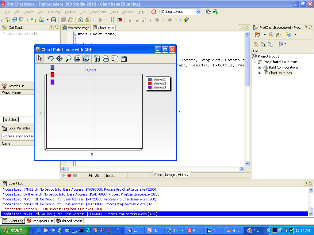

For this issue, the saving chart is not the place to start, this was the new issue I found after updating to the latest non-stable release. The charts are defined at design time, this happens with either bars(Chart) or lines(DBChart).
After the application has started, before any data is added if I start the editor from the button on TeeCommander, and then close the editor, the symbol for each bar or line is left on the left on the chart. If anything happens that forces a repaint of the chart the symbol go away. You can try to zoom, clicking on the chart if there is a event for clicking, basically forcing the chart to repaint. Ig I do the same with GHI selected rather than GDI+ (from 3D Render editor), then no problem
Hope this helps

Re: Problem After Saving Chart From Tee Comander with GDI+
Hi narcis,
Sorry for the delay in responding.
I have attached a screensot and a small app that caused it.
Not sure how this fits, while away I needed to update my mobile PC, with the latest release.

Back to the main problem with the repaints and atrifacts, it seems I did not fully understand how to produce the problem.
I clicked the Edit button on the Commander, then Closed the editor, No problem. I switched tabs, as the application has several tabs, with the Chart on a tab, came back to the tab with the chart and the artifacts appear, (the sysmbols for the chart ). if I do the same with Buffered Display not selected on 3D/ Render / GDI+ then then is not problem. With this option not selected, when you close the editor, the chart do a repaint once, you see the items painting. For the filcker you do not get the artifacts.
Hi Mike,
I could now reproduce the problem so I've added it to the defect list to be fixed asap (TV52015202).
It seems that for some reason, when you put some window over the left part of the chart, the legend symbols are repeated there.
